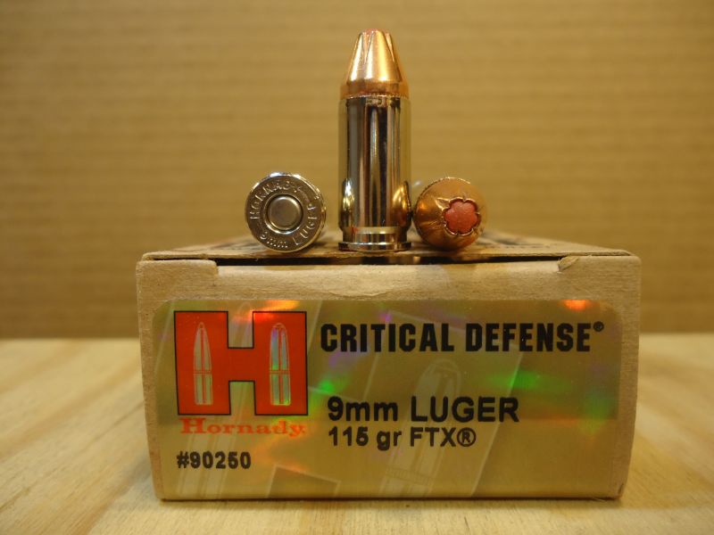

Cartridge is from Ammo Manufacture:  Hornady Critical Defense
Muzzle Velocity; Advertised:  1135 fps
Actual Instrumental Velocity:  1096 fps 3.1" barrel
                                            1166 fps 4.5" barrel
Muzzle Energy; Advertised:  329 Ft/lbs

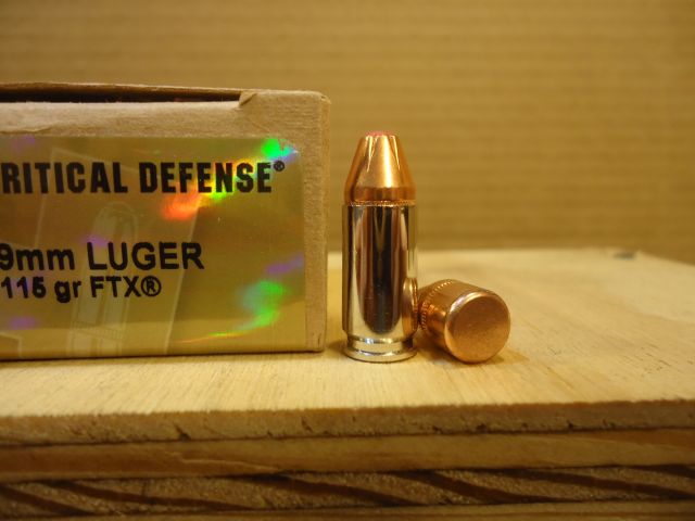

Brass Make/Head stamp:  HORNADY 9mm LUGER
Bullet Make/Weight/Construction/Info: Hornady 115gr FTX
Actual Weight:  114.8grs Diameter; .3552" Length; .595"
Crimp diameter:  .3750"
C.O.A.L.:  1.090"
Primer: Nickel Colored

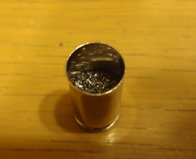

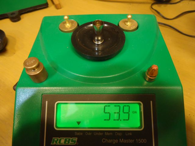

Case:  Brass  .752" Long;   53.9grs w/o primer
Rim Dia; .3877"   Base Dia .3865"

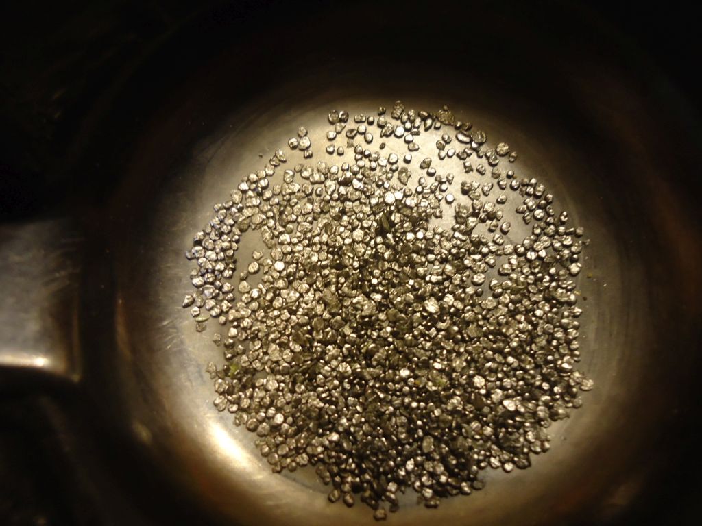

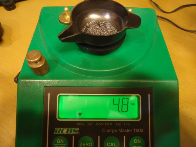

Powder Description/Positive ID/Type/Charge Weight:  Titegroup? Flattened Ball;  4.8grs.
This ammo has been done before, but I wanted to see what they would do out of this SIG SAS.
Also had a chance to shoot this in a 4.5" gun to see what the velocity difference would be.
