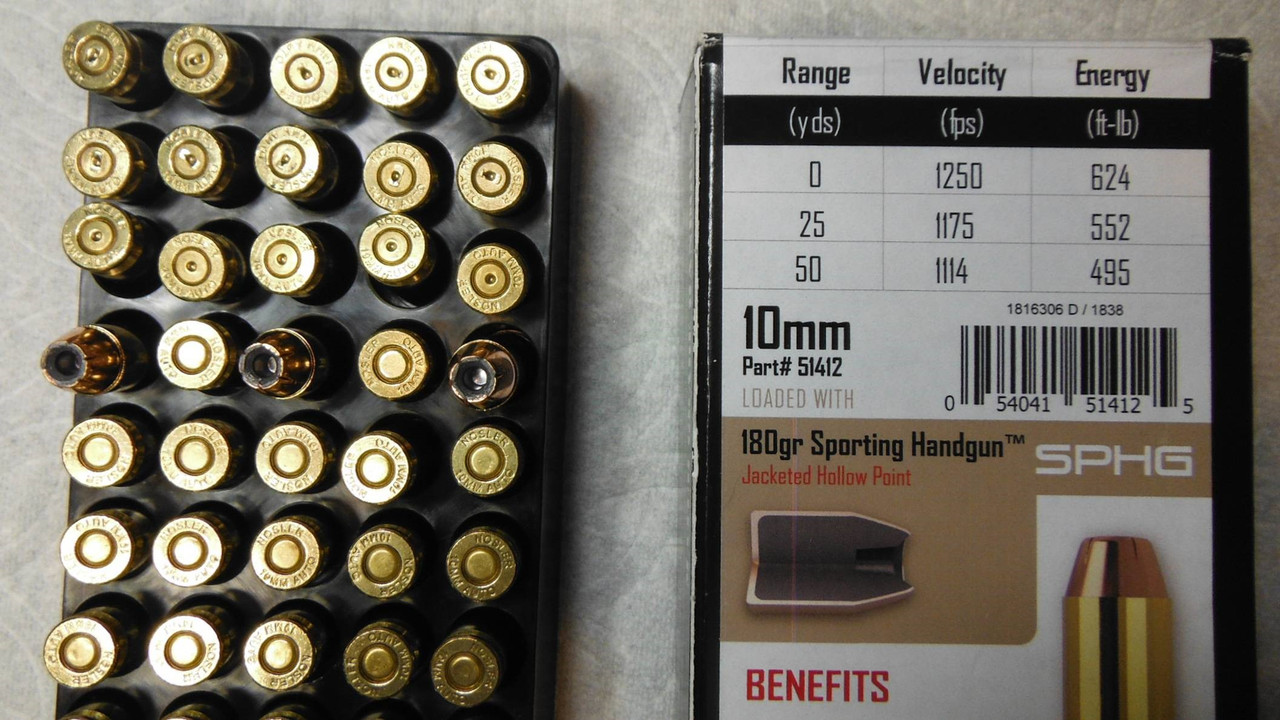

Cartridge is from Ammo Manufacture: Buffalo Bore 180gr JHP (Data was provided by Mr.Revolverguy 12/2019)
Muzzle Velocity: 1324 fps Verified with Chronograph
Muzzle Energy: 700 ft. lbs
Brass Make/Headstamp: Starline – Brass
Bullet Make/Weight/Construction/Info; Length 0.619"/Dia. 0.4000": Hornady XTP 180gr. JHP
HP depth 0.106" / HP dia 0.168"
Actual weight: 180.2 grains
C.O.A.L.: 1.251 Measured 10 rounds all very consistent
Primer: Large Pistol Silver color
Case: Crimp Diameter 0.421" Middle Diameter 0.419" Base/Web: Before the extractor groove 0.421?
Powder Description/Positive ID/Type/Charge Weight: Alliant Power Pistol 9.8 grains
💥Danger💥 Do Not try to replicate this load it may cause destruction or bodily harm💥
One of the viewers made a suggestion that I should fire 1 round a piece in each pistol and measure the brass. At first I thought wow that is a lot of work but my dedication to the viewers proved to be what I needed to get this done.
