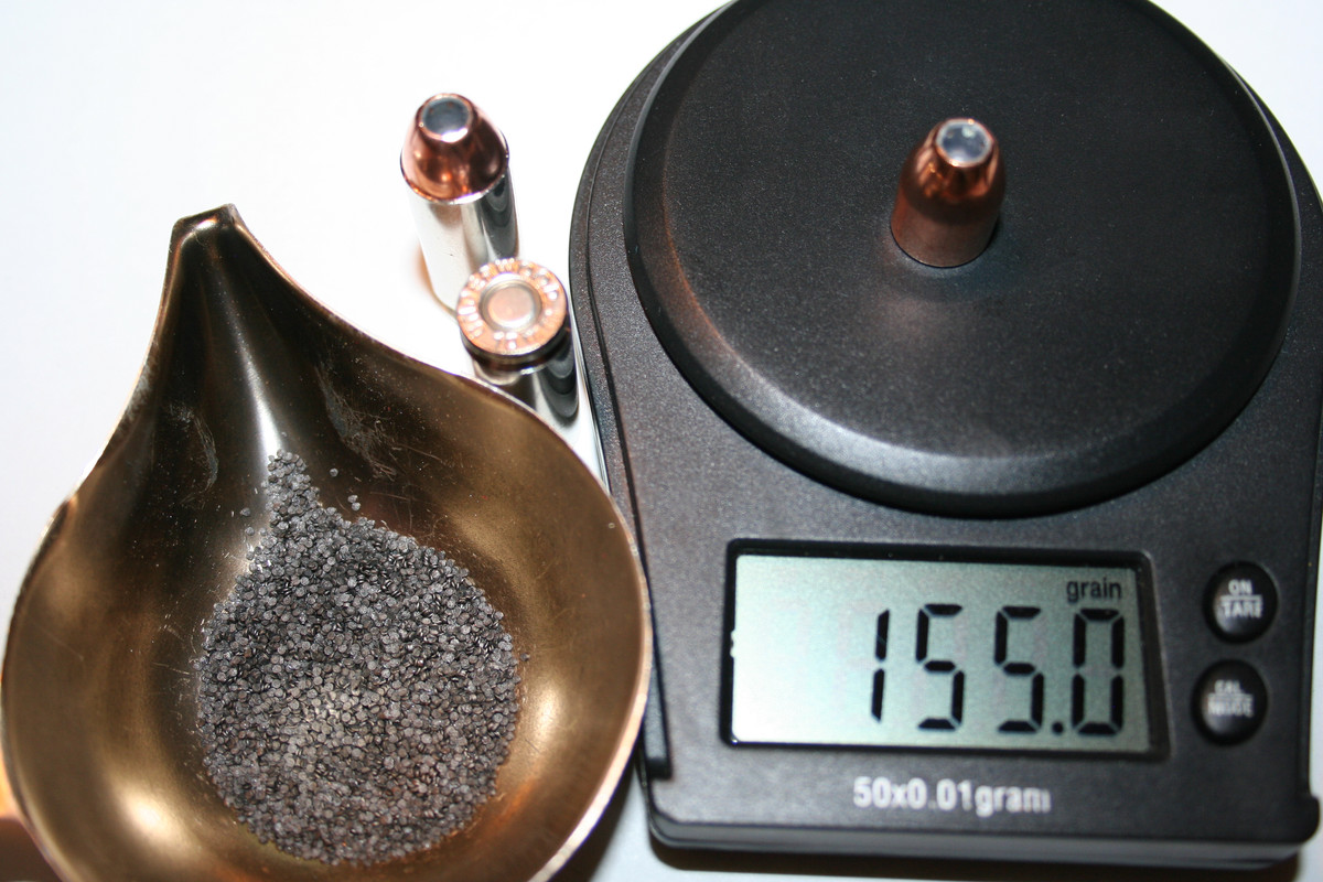

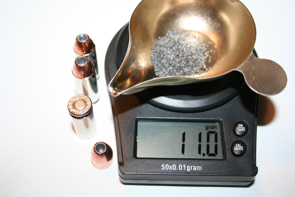

Cartridge is from Ammo Manufacture: NOSLER 180gr Nosler JHP (Data was provided by JAZZSAX8 12/2019)
Muzzle Velocity: 1250 fps ?
Muzzle Energy: 624 ft. lbs ?
Brass Make/Headstamp: NOSLER - Brass
Bullet Make/Weight/Construction/Info; Length 0.6130"/Dia. 0.4000": Nosler 180gr. JHP
HP depth 0.2040" / HP dia 0.1280" (tapered) / HP mouth 0.2300" (crimp ring 0.3985")
Actual weight 180.4 grains  (flat base)
C.O.A.L.: 1.2440" / 1.2440" / 1.2420" / 1.2450"
Case: Diameter 0.4230" Crimp Diameter 0.4215" Length 0.9870"

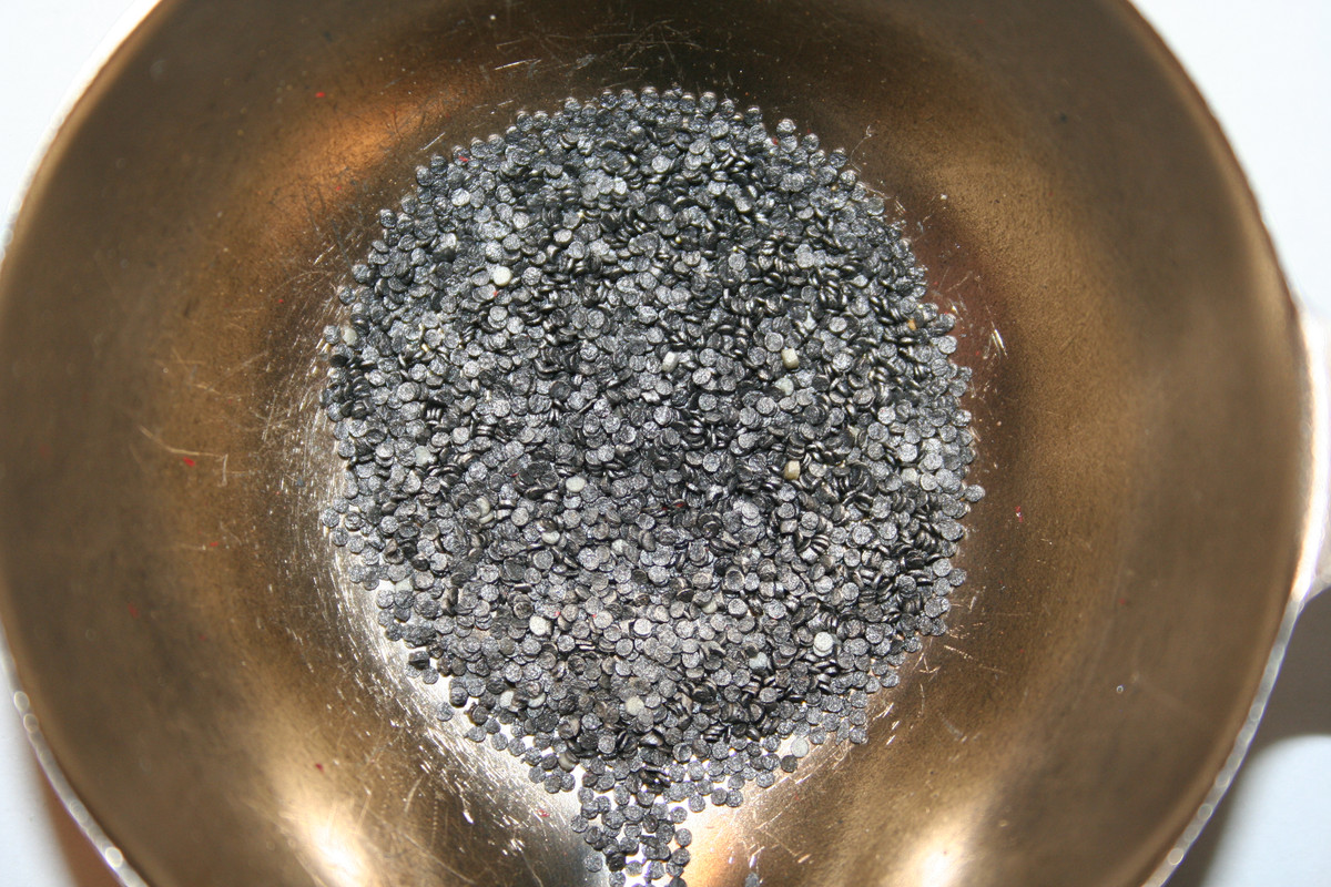

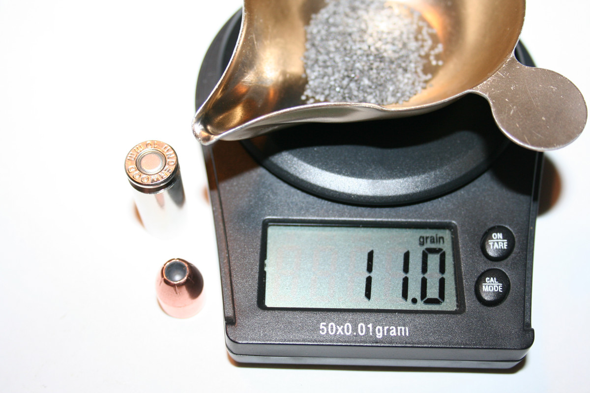

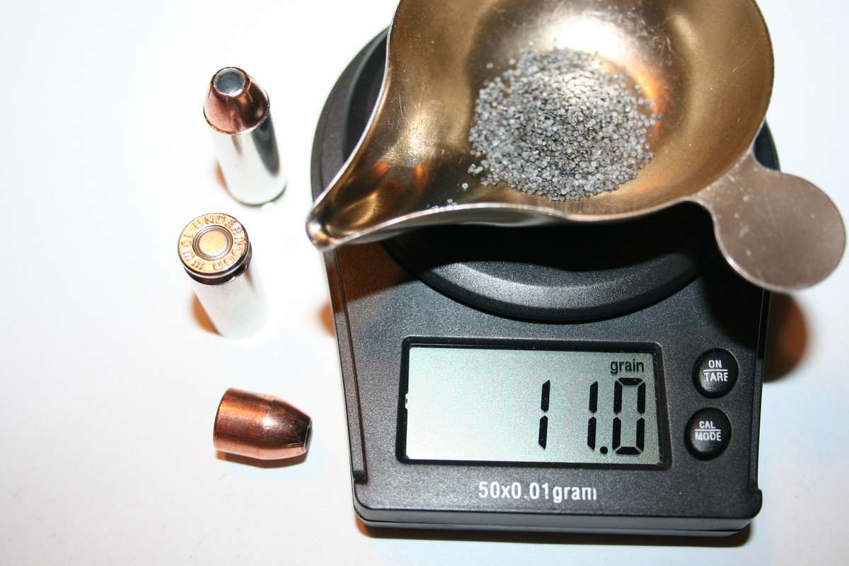

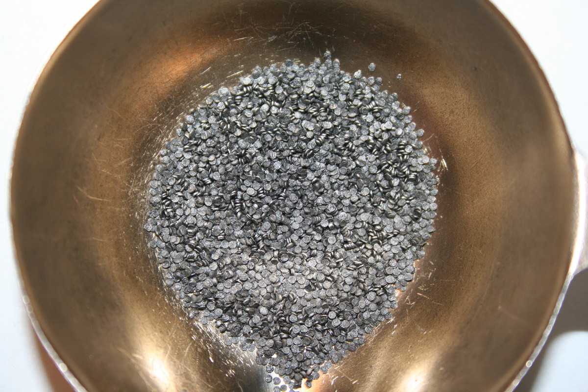

Powder Description/Positive ID/Type/Charge Weight: Alliant Power Pistol 8.0 grains
