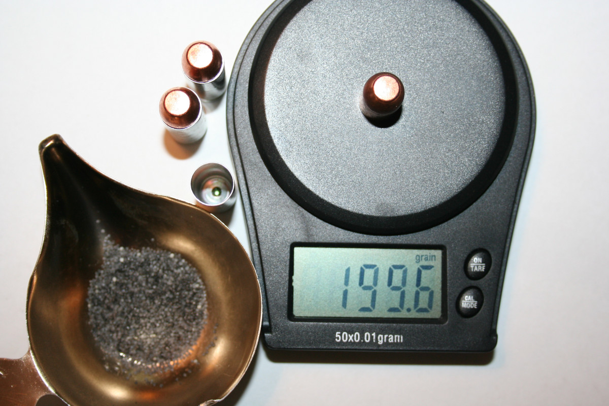

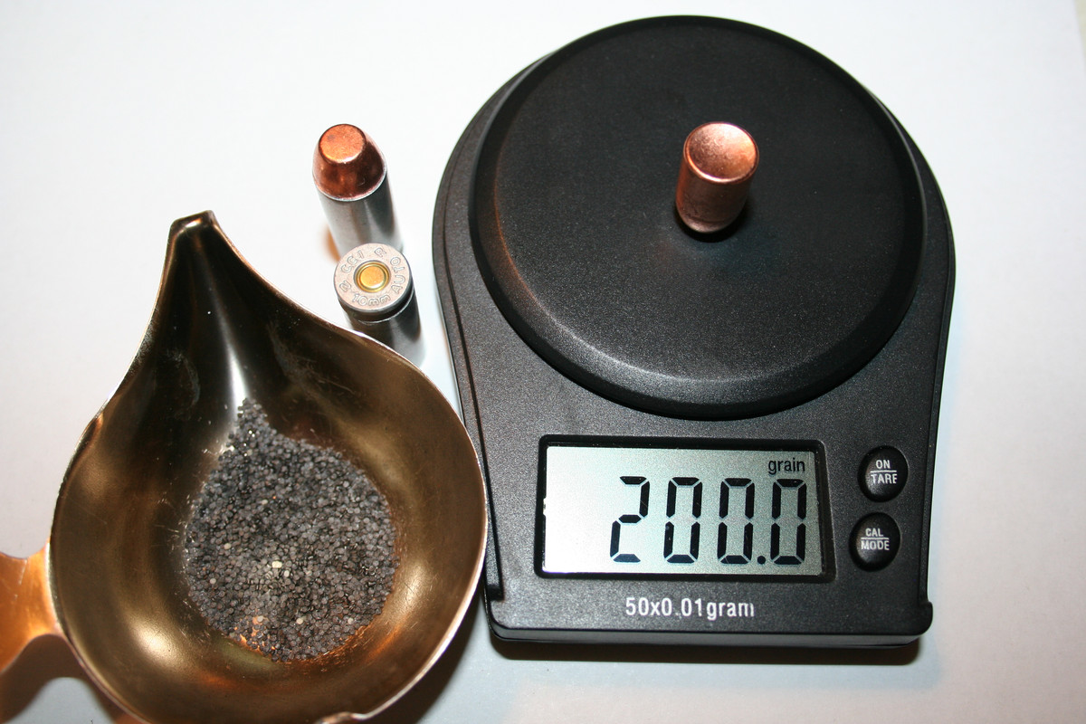

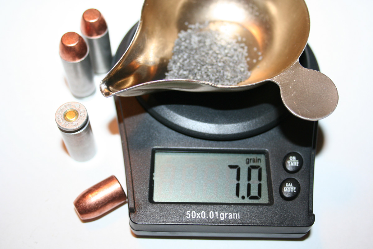

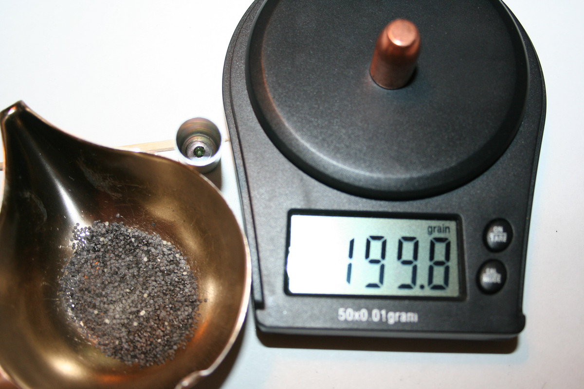

Cartridge is from Ammo Manufacture: Winchester 180 gr  FMJ (Redline 8/19)
Muzzle Velocity: 1080 fps
Muzzle Energy: 466 ft. lbs
Brass Make/Headstamp: Winchester - Brass
Bullet Make/Weight/Construction/Info; Length 0.6050"/Dia. 0.4000": 180gr. FMJ MEPLAT 0.2400" (Exposed Lead Base)
Actual weight 178.6 / 179.0 / 180.0 grains   Crimp squeezed bullet to 0.4000"
C.O.A.L.: 1.2505" / 1.2480" / 1.2500"
Primer: Large Pistol Primer Brass color
Case: Diameter 0.4215" Crimp Diameter 0.4215" (medium) Length 0.9850"

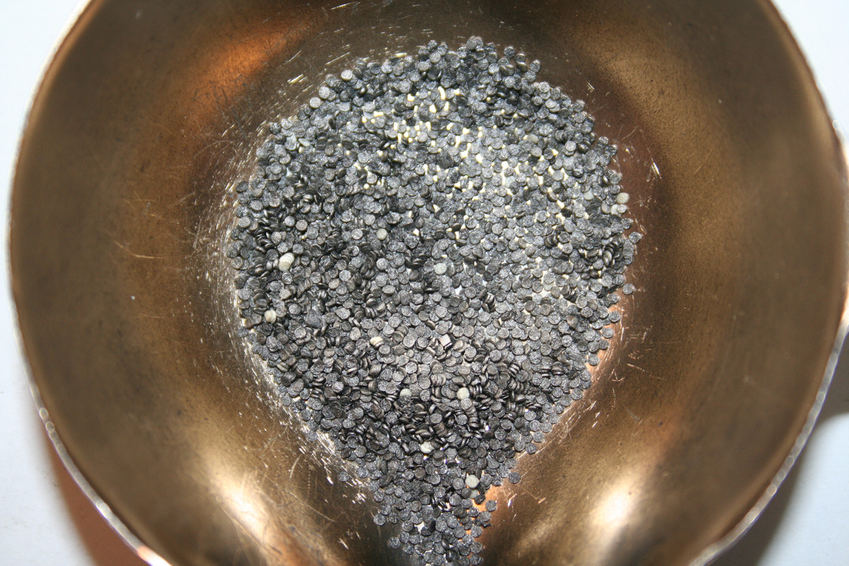

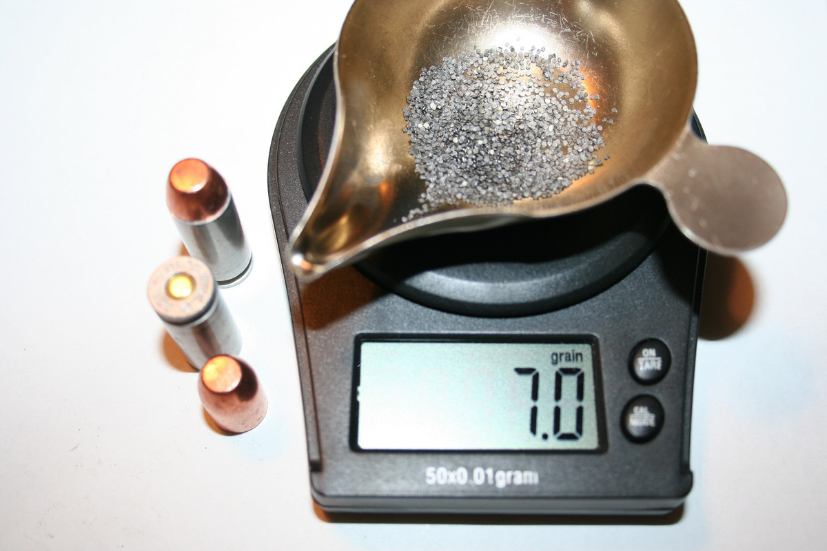

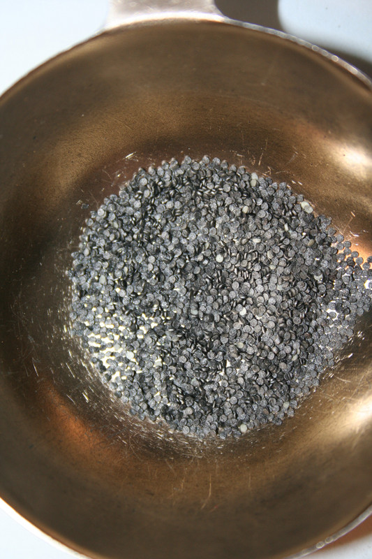

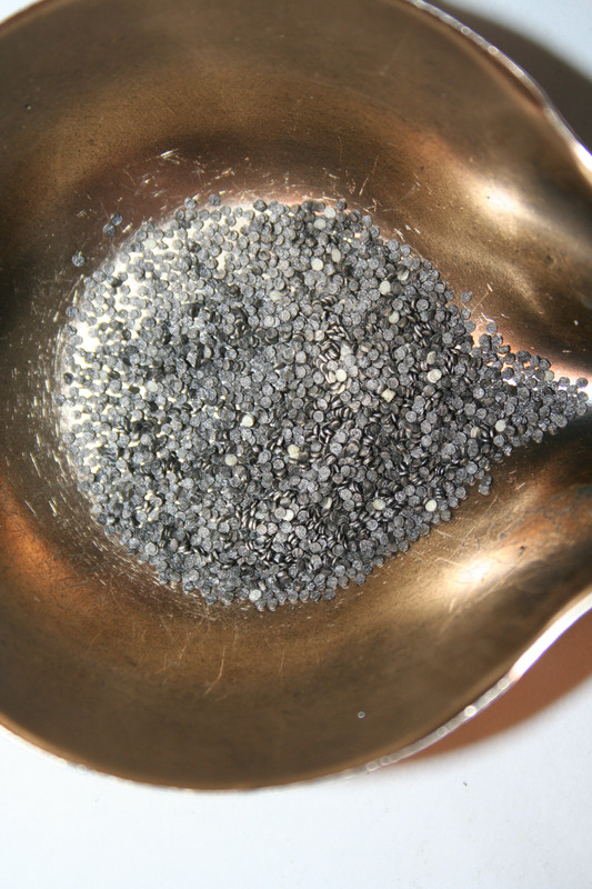

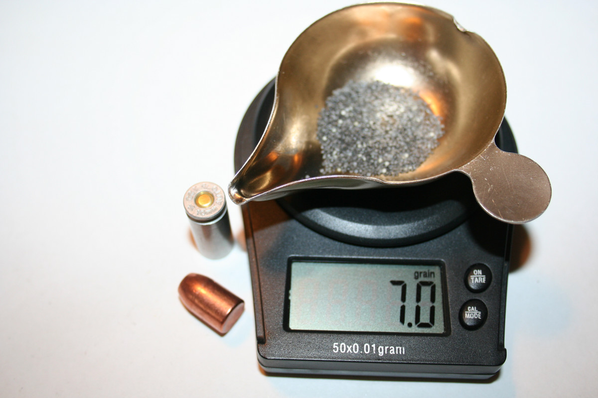

Powder Description/Positive ID/Type/Charge Weight: Win231 5.8 / 5.8 / 5.8 grains
Cartridge weight: 261.6 / 260.4 / 260.0
