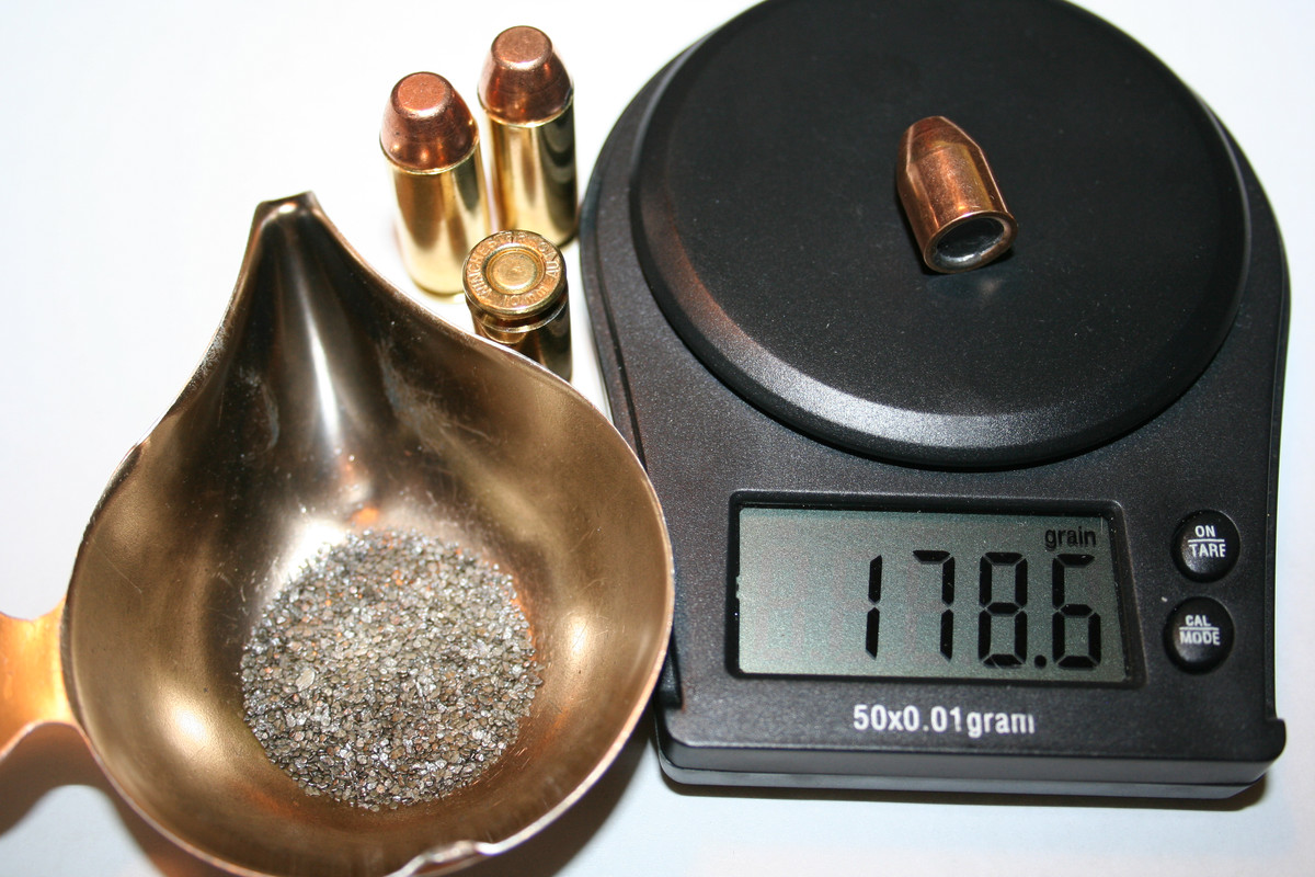

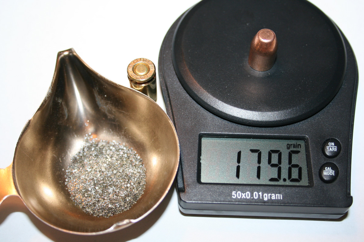

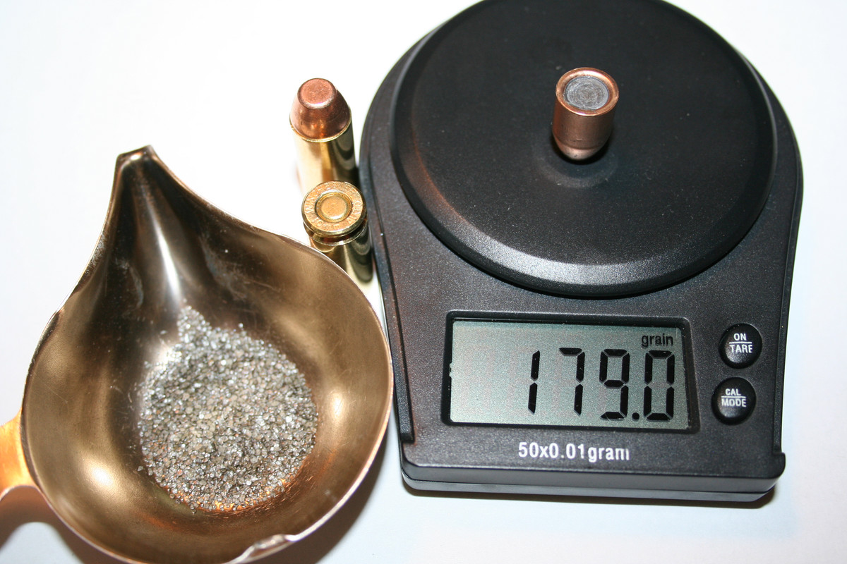

Cartridge is from Ammo Manufacture: Underwood 200gr Hornady XTP (Redline 8/19)
Muzzle Velocity: 1250 fps
Muzzle Energy: 694 ft. lbs
Brass Make/Headstamp: Underwood - Brass
Bullet Make/Weight/Construction/Info; Length 0.6840"/Dia. 0.4000": 200gr Hornady XTP
HP depth 0.1660" / HP 0.1850" tapered cavity, inner cavity  0.1200" / HP mouth 0.2250"
Actual weigh 200.6 / 200.8 / 199.8 grains /  Flat Base / Crimp Diameter 0.3990"
C.O.A.L.: 1.2440" / 1.2410" / 1.2420"
Case: Diameter 0.4215" Crimp Diameter 0.4215" (Light Crimp)Length 0.9880"

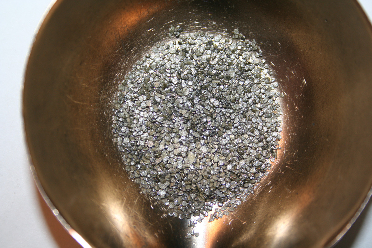

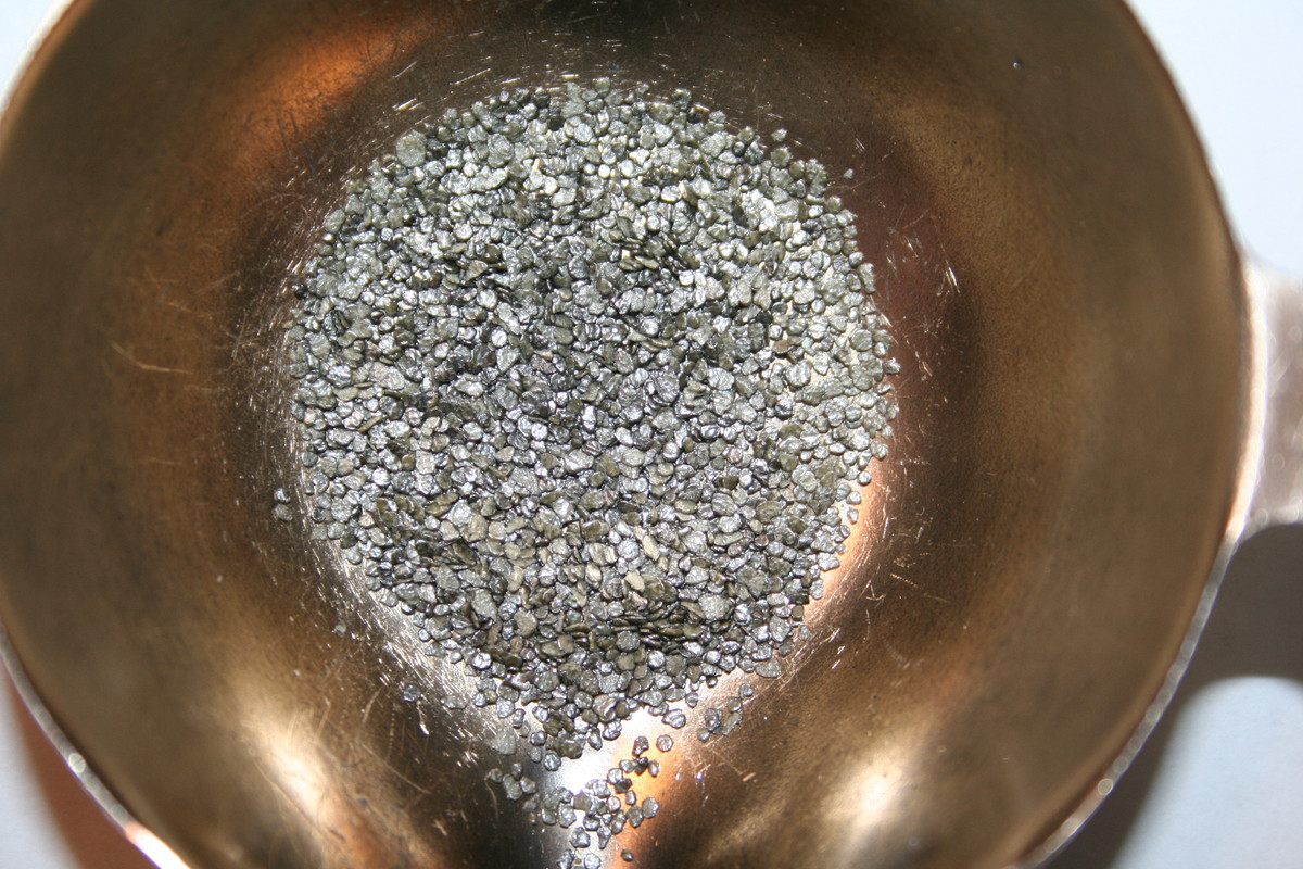

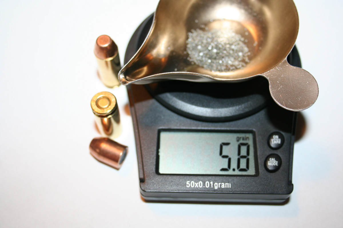

Powder Description/Positive ID/Type/Charge Weight: BE-86 8.6 / 8.6 / 8.6 grains  (Changed originally posted this as Power Pistol)
Cartridge weight: 284.8 / 285.4 / 285.6
I think these have BE-86 powder instead of Power Pistol because of the off color flakes in the mix...
