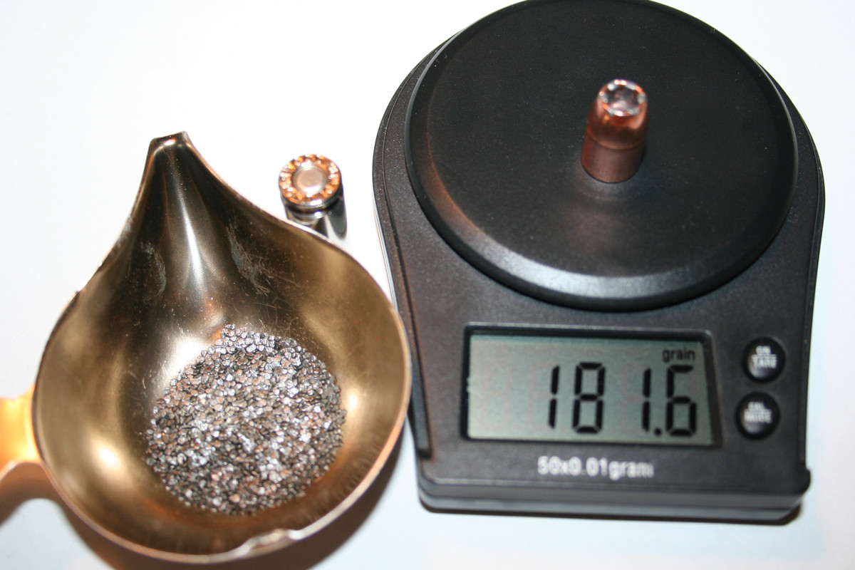

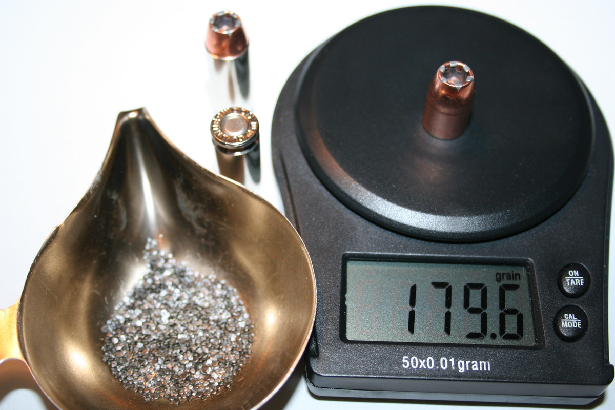

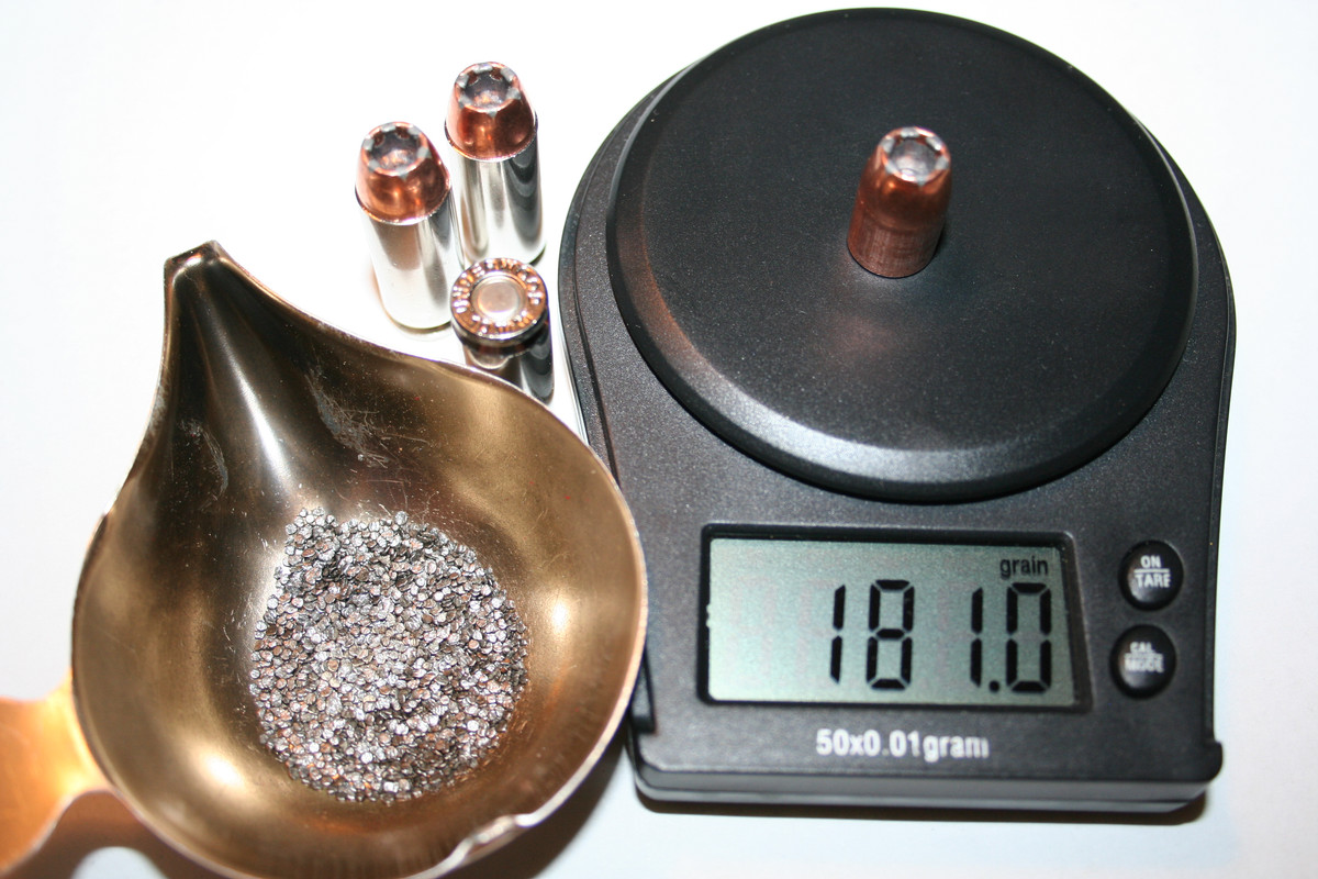

Bullet Make/Weight/Construction/Info; Length 0.6150"/Dia. 0.4000": 170 gr JHP
HPActual weigh 170.2 / 170.2 / 170.0 grains  Crimp Diameter 0.3975" Concave Base
HP depth  HP 0.1885" / HP dia 0.2000". (tapered) / mouth 0.2615" (six segment)

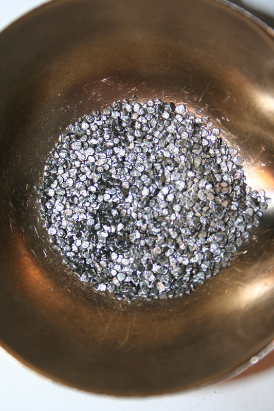

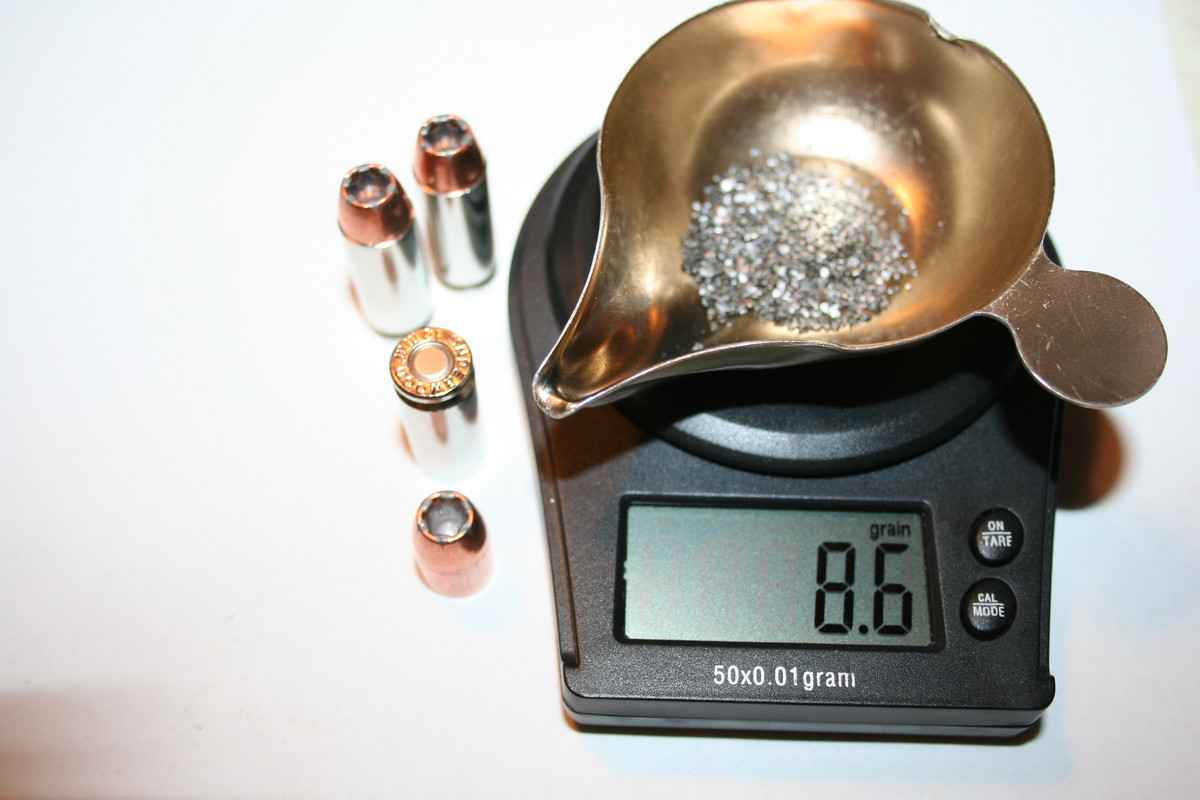

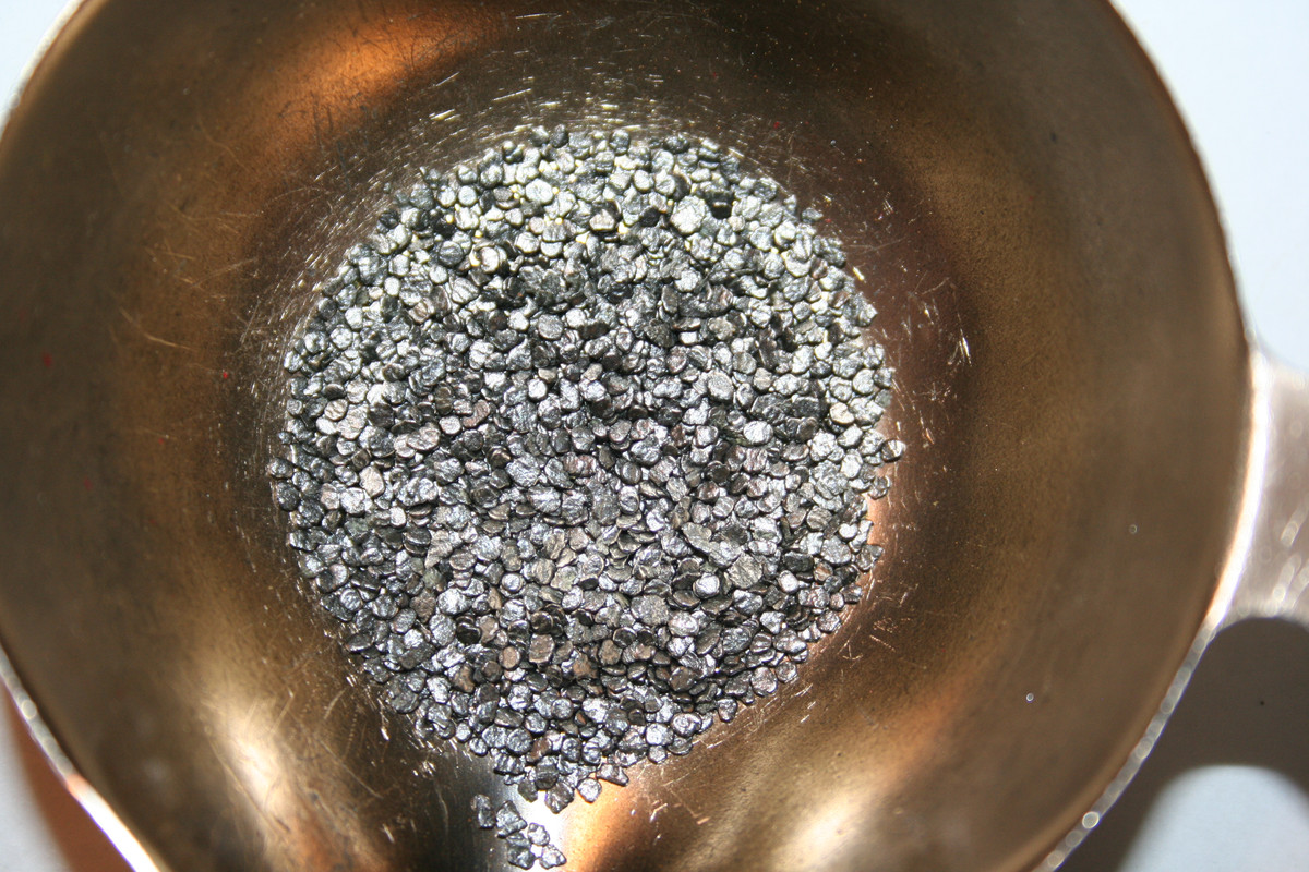

Powder Description/Positive ID/Type/Charge Weight: ? (unknow) ? 9.4 / 9.4 / 9.4 grains
Powder performance is similar to Silhouette
