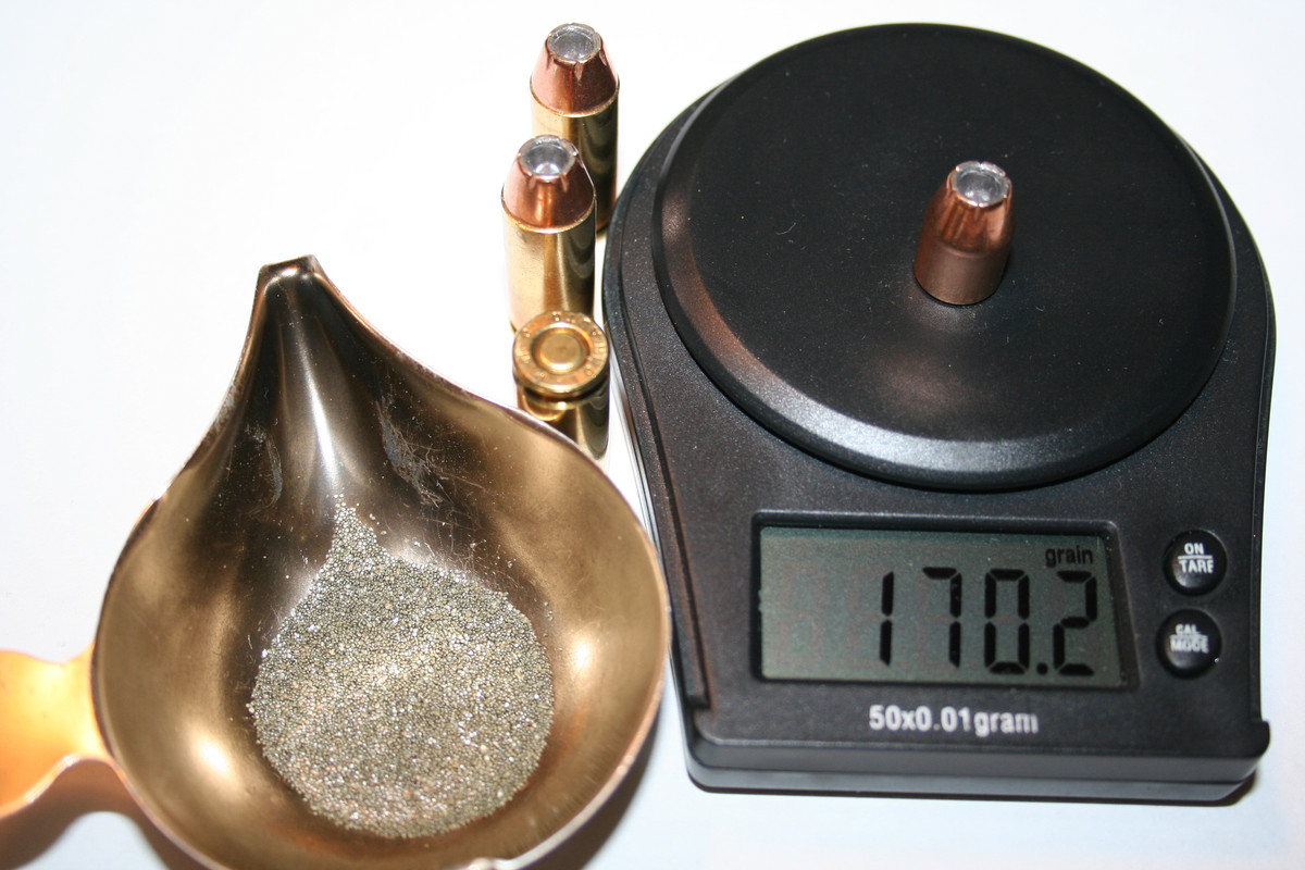

Cartridge is from Ammo Manufacture: Double Tap 180gr Control Expansion (Redline 8/19)
Muzzle Velocity: 1305 fps from 5" BBL
Muzzle Energy: 681 ft. lbs
Brass Make/Headstamp: Starline - Brass
Bullet Make/Weight/Construction/Info; Length 0.6400"/Dia. 0.4000": DT Custom 180gr. JHP
HP Depth 0.2200" / inside Dia. 0.2185" tapered / mouth Dia. 0.2565"
Actual weight 180.2 / 180.0 / 180.0 grains / Flat base / Crimp squeezed bullet to 0.3995"
C.O.A.L.: 1.2420" / 1.2420" / 1.2435"
Primer: Large Pistol Bronze color
Case: Diameter 0.4215" Crimp Diameter 0.4190" (Tight) Length 0.9850"

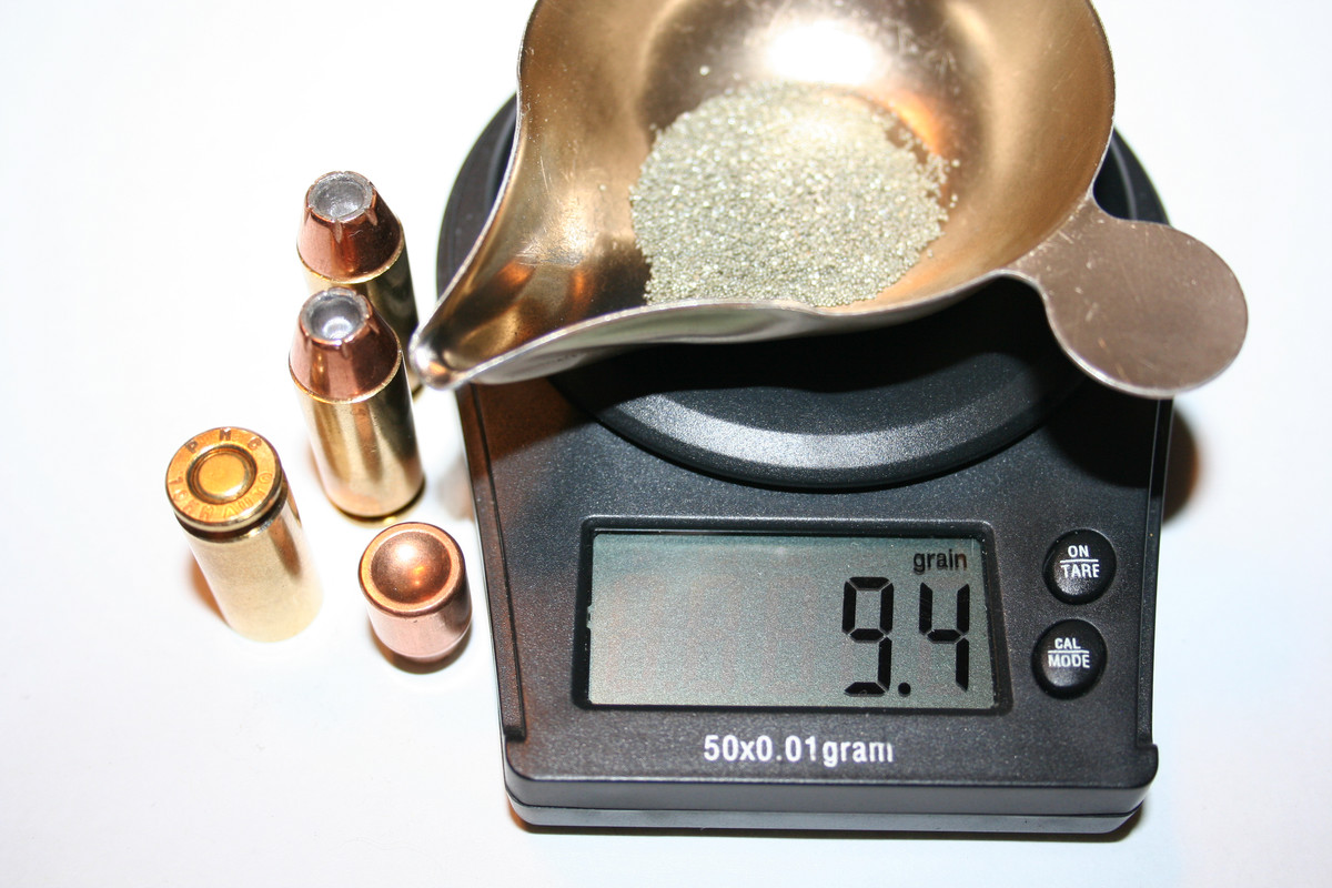

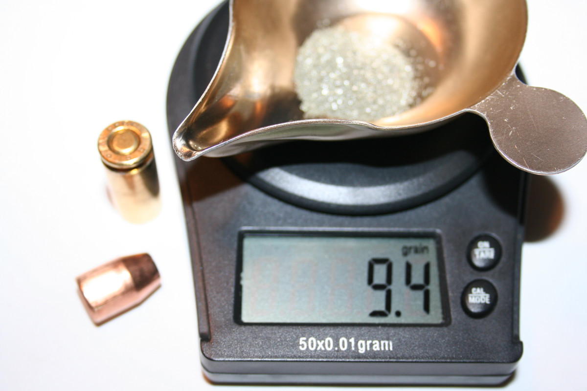

Powder Description/Positive ID/Type/Charge ? Silhouette ?
Weight: 8.8 / 8.8 / 8.8 grains
Cartridge weight: 264.6 / 264.4 / 265.0
Real consistent...
