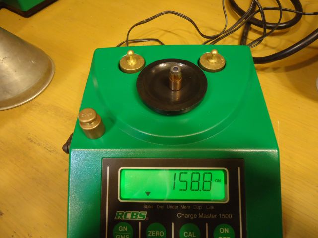

Bullet Make/Weight/Construction/Info:  Winchester 110gr Jacketed Hollow Point
Actual Weight: 110.4grs.

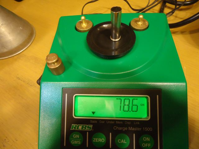

1.152" long; 74.8grs w/primer

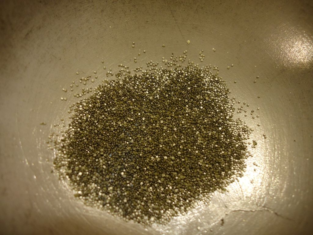

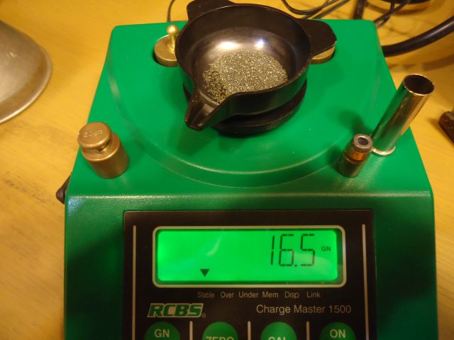

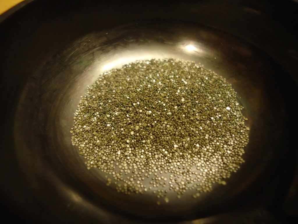

Powder Description/Positive ID/Type/Charge Weight:  Medium Flake;  7.2 grs.

This is not the typical Winchester powder that they produced (typically flattened ball types), I have to wonder if they were loading with other powders from other companies to make this one...
There used to be a commercial powder from Dupont called SR- 4756 which late became IMR SR-4756...
However data I have, shows 110 grain JHP only 6.1 grains making 1098 fps from a 6" BBL
