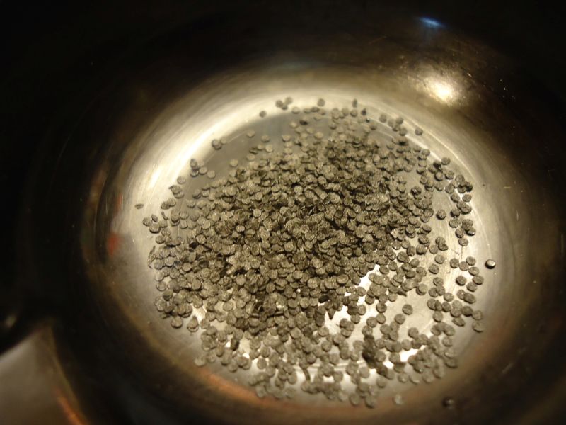

Powder Description/Positive ID/Type/Charge Weight: Small Flake.
Looks like Bullseye
Sample #1;  3.7grs.
Sample #2;  4.1grs.
