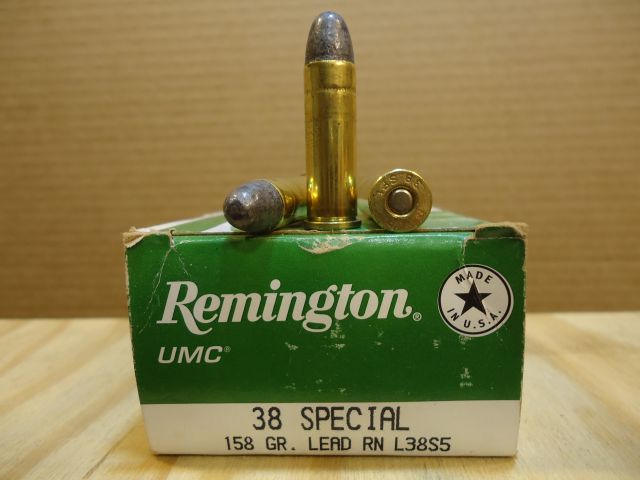

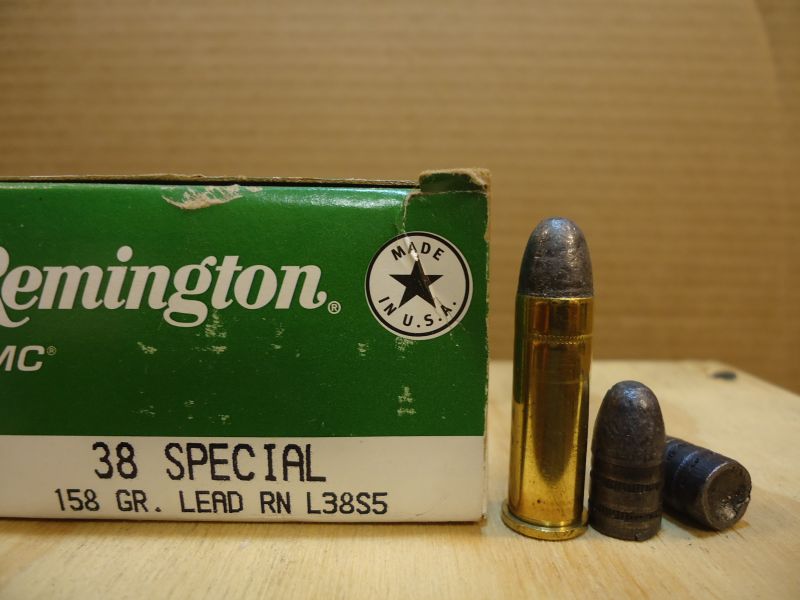

Cartridge is from Ammo Manufacture:  Remington 38 SPL Lead RN  Wheelgun

Brass Make/Headstamp:  R-P 38 SPL

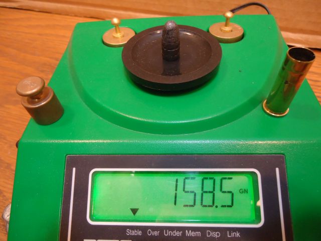

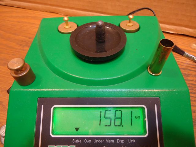

Bullet Make/Weight/Construction/Info: Remington swaged 158gr Lead RN
Actual Weight:       Bullet #1;  158.4grs.  Diameter;  .3554"- .3560"
                            Bullet #2;  158.5grs.  Diameter;  .3542"- .3550"
                            Length; .711"
Crimp diameter:   .374"
C.O.A.L.:        1.530"
Primer:        Nickel;  Rem 1½
Case:          Nickel

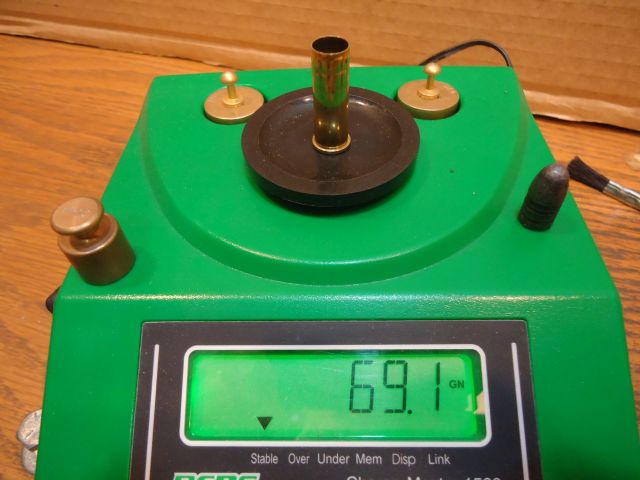

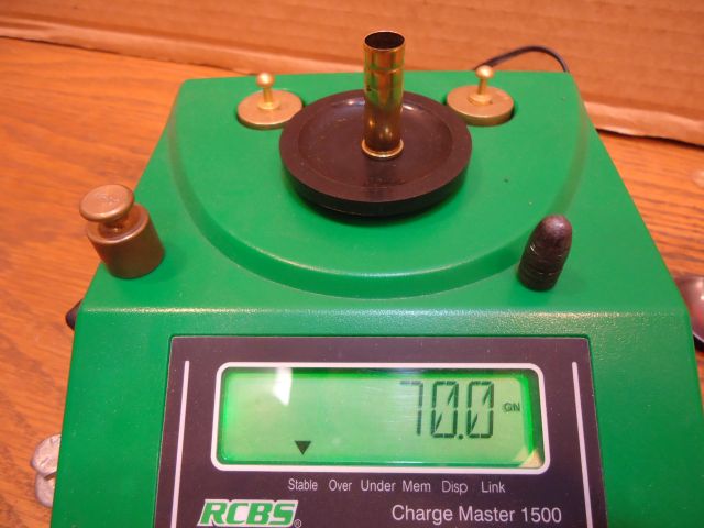

                   Case #1;  Length;  1.149"   Wt.;  70.0grs. w/primer
                   Case #2;  Length;  1.149"   Wt.;  69.7grs. w/primer

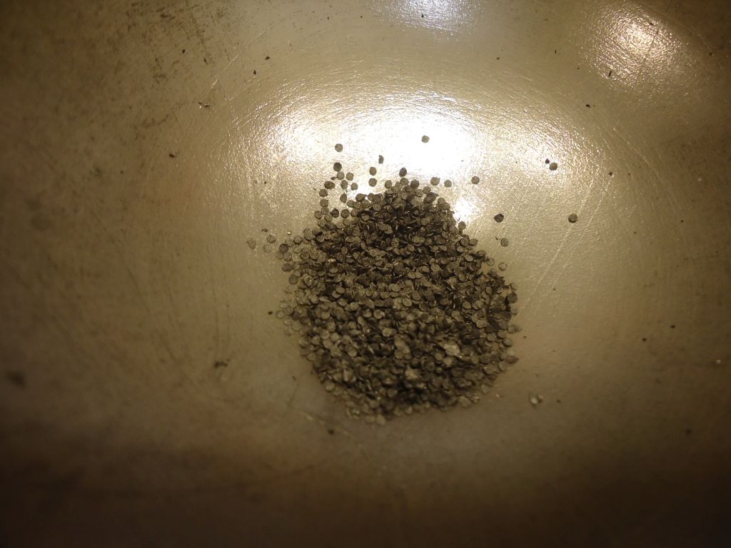

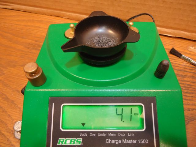

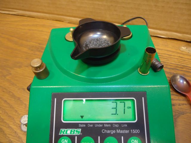

Powder Description/Positive ID/Type/Charge Weight: Small Flake.
                                         Sample #1;  3.7grs.
                                         Sample #2;  3.8grs.
Bullets were a little undersized from the .358" diameter expected.
