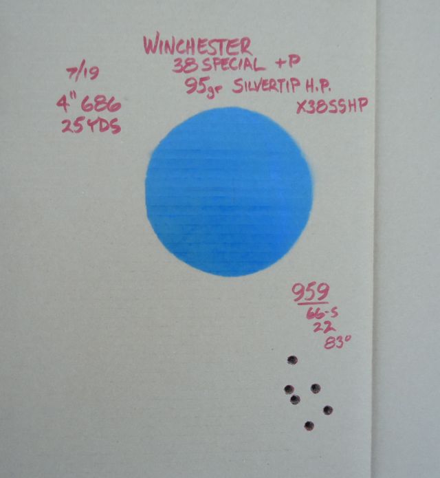

Cartridge is from Ammo Manufacture:  Winchester .44 Magnum
Muzzle Velocity; Advertised:   1250 fps
Actual Instrumental Velocity:   1294 fps; 10' from muzzle
Muzzle Energy; Advertised:   867 ft/lbs
Target Circles 4"

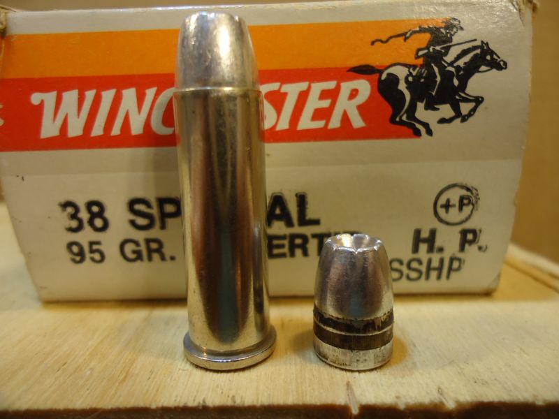

Brass Make/Head stamp:   W-W Super 44 Rem Mag
Bullet Make/Weight/Construction/Info:  250 gr. Winchester Platinum Tip;
Actual Weight:  250.1 grs.  .4296" dia;  .758" long
Crimp diameter:  .4285"
C.O.A.L.:   1.593"
Primer: Win brass color
Case:  Nickel;  110.9 grs. w/primer

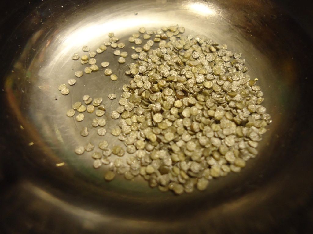

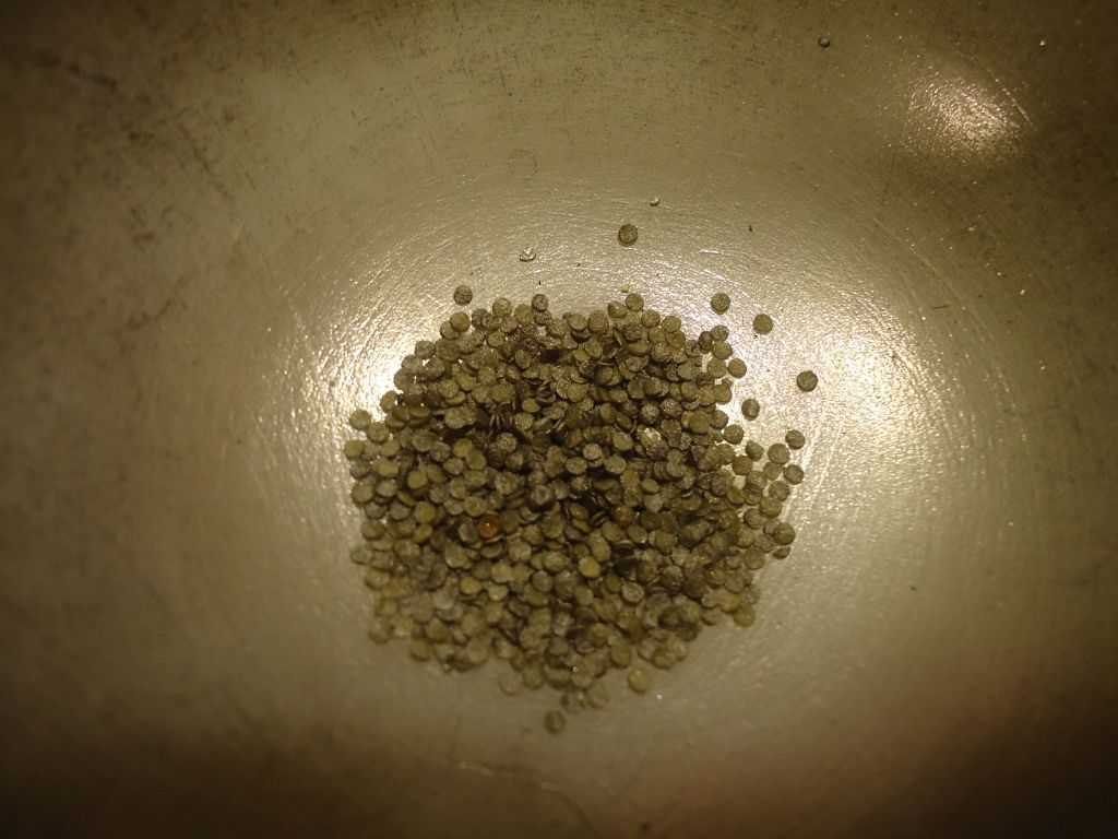

Powder Description/Positive ID/Type/Charge Weight:  Flattened ball; H-110/296; 22.1 grs.

I agree the powder appears to be the Winchester 296 which is the same as Hodgdon H-110
