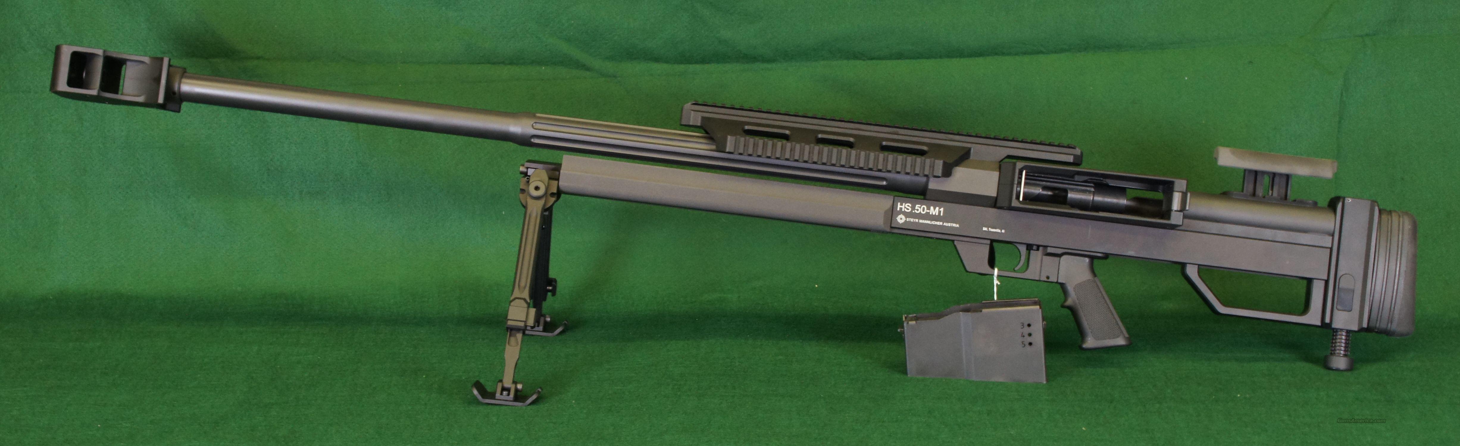

If "budget" isn't as much of a consideration, I own one of these (HS-50) and for a non-custom built rifle, it shoots very well.
The Steyr HS50:
Or, the side-box, mag-fed version of it called the HS50 M1 (click on this link to see the pic; too many pixels for the forum page):
https://www.gunsamerica.com/userimages/137525/958192396/wm_4549640.jpg
Here's both (the guy on the left is Eduardo, past president of the FCSA):
The HS50 comes with the nice/aluminum bipod setup you see in those pics. It has a very effective clamshell-type muzzle brake on it which can also be disassembled for cleaning periodically. Cold hammer forged 33" to 36" barrel; 1:15" twist, and is chambered to fit almost all mil-spec .50BMG ammo you will find. It's a semi-bullpup type of configuration so when it's assembled its slightly shorter than a conventionally stocked .50 rifle. It comes with the tools to break it down into 2- @1/2 size elements. Because the optics remain fixed to the barrel portion of the action, there is no loss of zero experienced when breaking-down and reassembling the rifle. I think they come standard with a 20 or 30MOA scope rail. The M1 version also had side mounted picatinnies for accessories; ie: NV gear etc...
With "the right ammo" my HS50 has done @.75MOA at a distance. The gun was designed to shot from prone and it does well at that or the bench.
I think they can be had for "$4000-ish", without glass of course???
