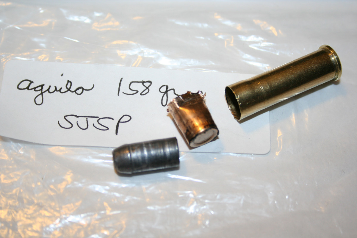

Cartridge is from Ammo Manufacture: Aquila Ammo 158 Gr SJSP(supplied Intercooler)
Ballistics Information: 357 Magnum
Muzzle Velocity: 1545 fps *10" BBL
Muzzle Energy: 838 ft. lbs
Brass Make/Headstamp: AQUILA – Brass
Bullet Make/Weight/Construction/Info; Length* 0.6600"/Dia. 0.3570": 158gr. SJSP
Actual weight 157.0 grains  crimped heavy / Sealant glued the jacket tight
MEPLAT 0.2140"  (dimpled base)
C.O.A.L.: 1.5595"
Primer: Small Pistol Brass color
Case: Diameter 0.3755" Crimp Diameter 0.3730" Length 1.2820"
Powder Description/Positive ID/Type/Charge Weight: H-110 / W296  15.6 grains
* Length* 0.6600" (based off putting the bullet back together)
Bullet came apart when pulling because the sealant glued the jacket tight.
