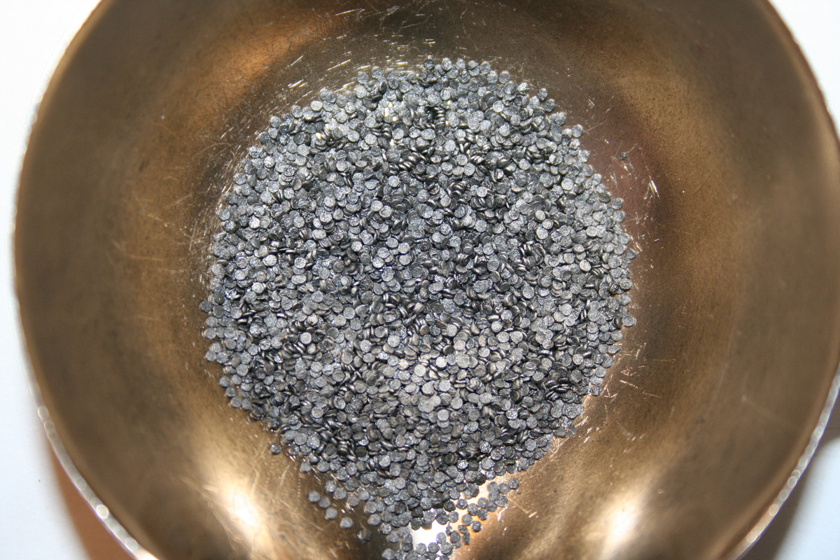

Powder Description/Positive ID/Type/Charge Weight: Alliant Power Pistol9.8 grains
