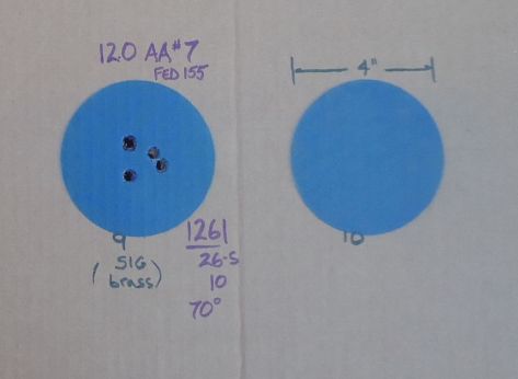

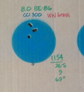

Just stumbled on a couple nice loads with a generic 165gr FMJ
BULLET WEIGHT: 165
CASE MFR.:  Winchester
PRIMER:  CCI300
POWDER:  BE-86
CHARGE WEIGHT:  8.0
OVERALL CARTRIDGE LENGTH: 1.260"
VELOCITY:  1150 fps
OTHER DETAILS:  G20-SF  Vortex Viper; 25 yds.
BULLET WEIGHT: 165
CASE MFR.:  SIG
PRIMER:  FED 155
POWDER:  AA #7
CHARGE WEIGHT:  12.0
VELOCITY:  1260 fps
