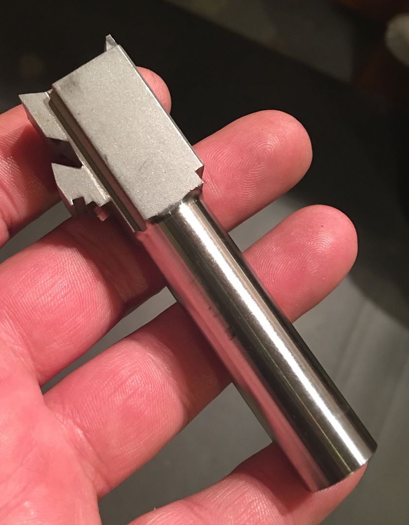

Well couple months back I happened upon a "deal" on a barrel and magazines for my G27. The barrel is NOT marked for anything but caliber and "CL". I grabbed it, wishing it was a G23 so I could try in both sized guns.
Any one know who makes it??

May be Glock 23/32 National Match conversion barrel by Olympic Arms.
Caliber: 357 SigNM
Rifling: Broach-cut National Match
Material: 416 SS Bar-stock
not CL but GL for Glock
