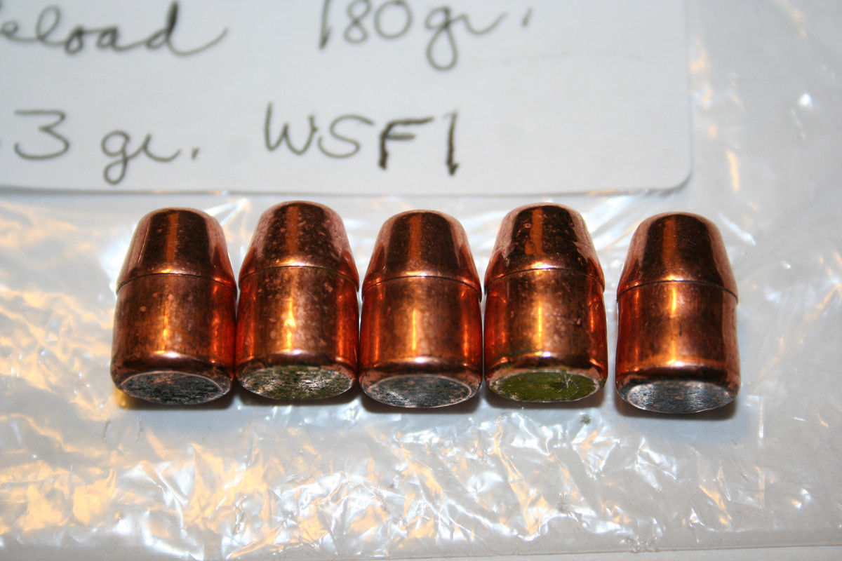

These were the bullets from the Dec 2013 over crimp issue that resulted in not chambering
