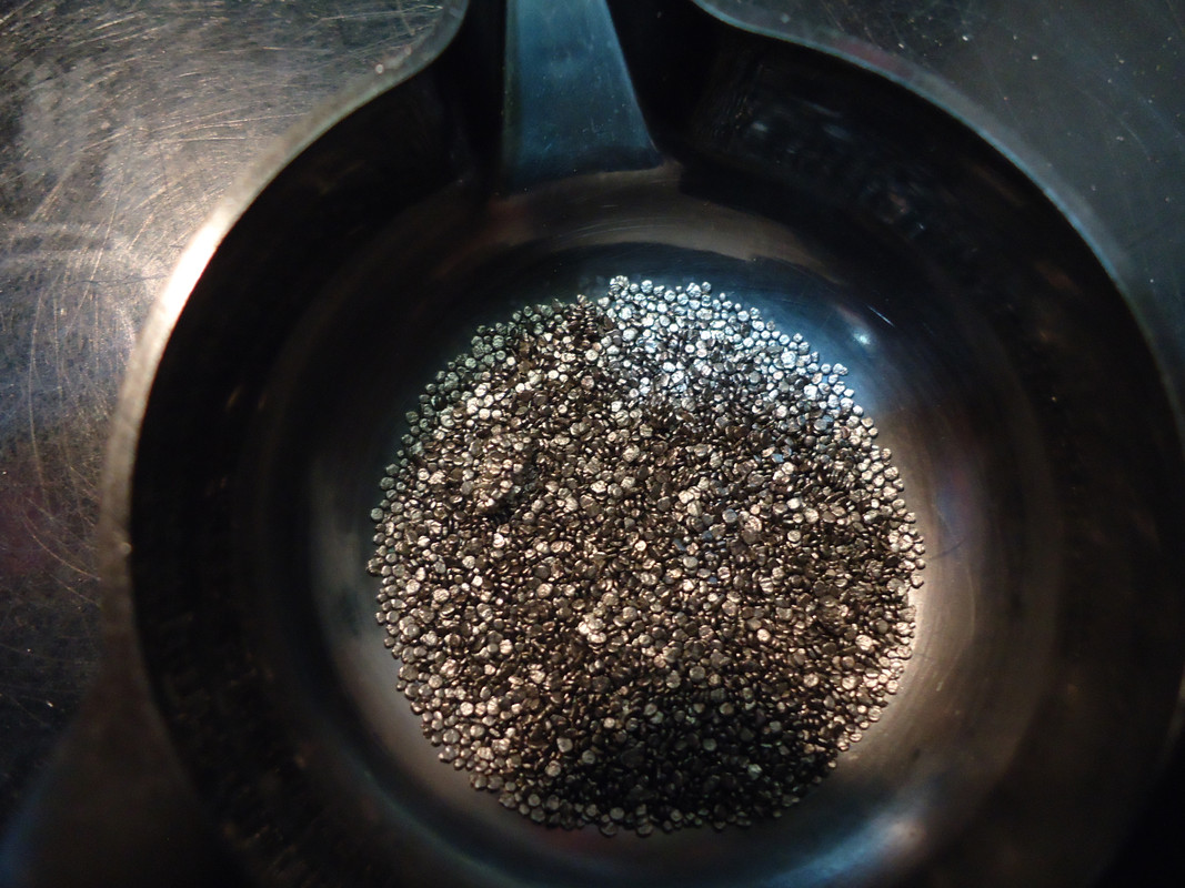

Rdub the Buffalo Bore 158 JHC with 19.8 grains appears to be Lil'Gun powder. (Hodgdon shows 18.0 grains @ 1577 fps)
I don't know Shadow... That stuff was pretty weird looking. The photo really doesn't show how shinny it is..  Did you notice how 'clumpy' it is? Lil'gun is quite dull in comparison..  Never seen anything quite like what ever that is..
#25
Here is the picture of Lil'Gun I took today...
Here is the one you posted...The clump was probably a compressed charge in the BB cartridge...
Well I weighed out 19.8 grs of Lil'gun and put it into a Winchester case and there is enough room barely for a 158gr bullet.
I suppose one could work up from 18.0grs to 19.8grs a few tenths at a time and see how it goes...
But, I'll bet we run into pressure before reaching 19.8grs. of canister Lil'gun.  I'm willing to try it, but southern Oregon is currently on fire and the woods are closed down until we get some rain.  No rain is sight for a while..
