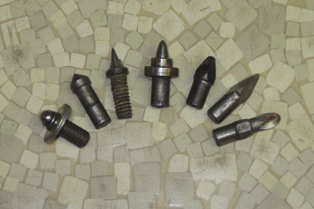

Another option for making the hollow points bigger, since your a cast bullet guy too - put them in your luber-sizer press, and use a pointed top punch to open up the hollow point. I do this a lot with Montana Gold bullets, since their hollow points are not generally very impressive. You can use different shapes of top punches too, to make all kinds of cool hollow points.
Here are some of the punches I use for this:
