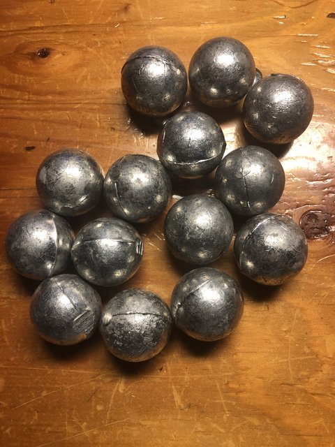

I  do have the attached laying around, but would likely not be of any value for casting, but I guess I don?t know. They are used in the printed circuit board industry, and are 60% tin, and 40% lead, measuring aprx 1.5? in diameter
https://i.postimg.cc/nc39n77Y/FDDC248-F-789-A-411-D-8-BD1-AC143-C7-EA695.jpg
blaster
I would throw those balls in the pot. I don't know if plumbers still use much lead ingots for cast iron pipe but that was a good source. also old roof vent flashings are lead.
So the tin content isn?t to high? 60% tin and 40% lead
Thanks Blaster
blaster
by themselves the tin is high but mixed with other scrap or pure lead it shouldn't be. I could be wrong as I am not a metallurgist or expert in casting, but I think a high tin content only raises the melting temperature a bit and makes a lighter bullet. others more knowledgeable might tell you different. the thing you DO NOT want to do is get any Zinc in your melting pot. it turns to "cottage cheese". I am told.

Tin is used to harden the bullet, as well as to aide in the fill out of the mold.   Tin and antimony both hard the lead, but in different ways.   Antimony can make your mix more brittle.

Just seems like there should  be a use for these 60% tin / 40% lead balls, but if not, they can just continue gathering dust 😀
