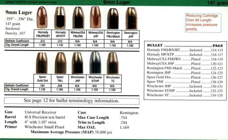

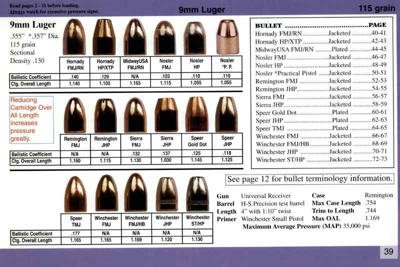

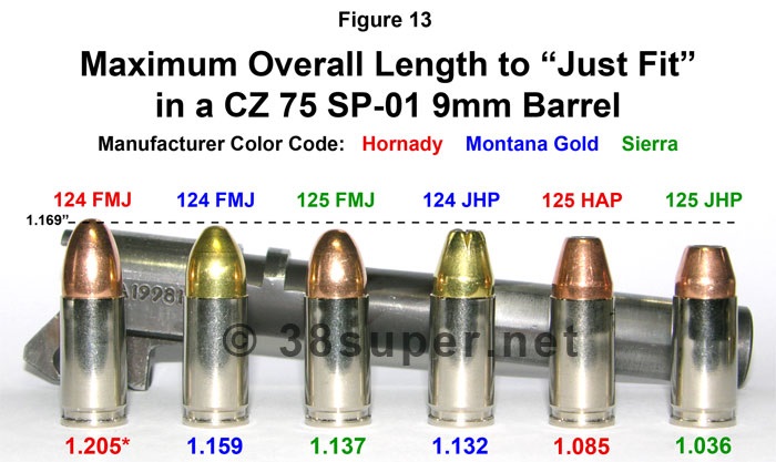

9mm has a long-loaded length 1.169", Hornady 147 grain is shown as 1.135",  My suggestion is to try different seating lengths closer to the longer 1.169 that still fit in the magazines.
