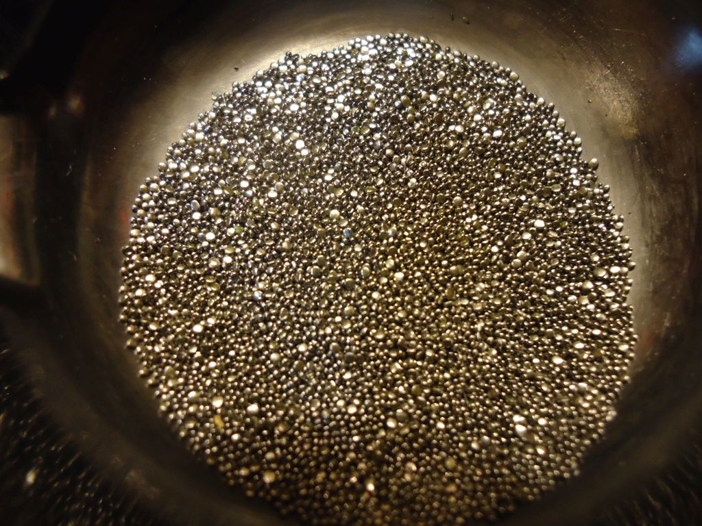

Powder Description/Positive ID/Type/Charge Weight:  Small Flake; 5.0 grs.
Very Nice RDub...do you thing the powder is Bullseye or Power Pistol?
Hey
It looks very similar to both...Power Pistol is out because you can't get that velocity with 5 grains.. You'd need to be closer to 6 grains. With Bullseye, four different sources say 4.4grs is max with 124gr FMJ bullets, Ken Waters likes 4.6 for max. I think 5 grains would be pushing it.. I was thinking BE-86, but even with that, you'd need something closer to 5.5grs.  Not sure with this one....
Quote from: RDub01 on April 06 2021 06:41:44 AM MDT
Hey
I was thinking exactly the same thing. Could be a non canister version of either that Remington tested on their own and came up with this load. Could be a hot load of Bullseye, especially since you got more than the advertised velocity out of it. 6/10s of a grain seems like a little too much, though.
Based on data from Speer #11 they actually show the 124 grain FMJ over 5.0 grains of Bullseye @ 1148 fps. It also shows the 125 grain soft point using the same 5.0 grains @ 1163 fps.
I think it is Bullseye, (may not be an altered form)   Speer #11 was before the data was getting watered down... ;D
Defiantly not BE-86
Just out of curiosity Shadow, what was the COAL from the Speer #11? Also was it measured in CUP or psi?

Thanks Shadow. It probably is Bullseye. That would make sense from a cost standpoint, as well. I do find it interesting that Remington loads within .03" of a pretty serious pressure increase, according to Speer.
I looked back through the archives and found the Speer manuals varying a bit with Bullseye and the 124-125gr load.. #8 lists 4.8grs, #9 4.2, #10 4.6, #11 5.0, #12 to present, 4.4grs. Speer 125gr bullets have gone through some design changes over the years. Each design no doubt had their own pressure curves.
Older Hornady liked 4.4grs. Hornady 9th didn't even list Bullseye..
Older Sierra liked 4.5grs.
Yet an older Alliant manual lists 4.9grs as max.
Could very well be Bullseye.. Maybe this comes from a lot that is on the slow side for this powder..
I'm wondering if powder manufacturers are just backing off previous load maximum's due to liability reasons
