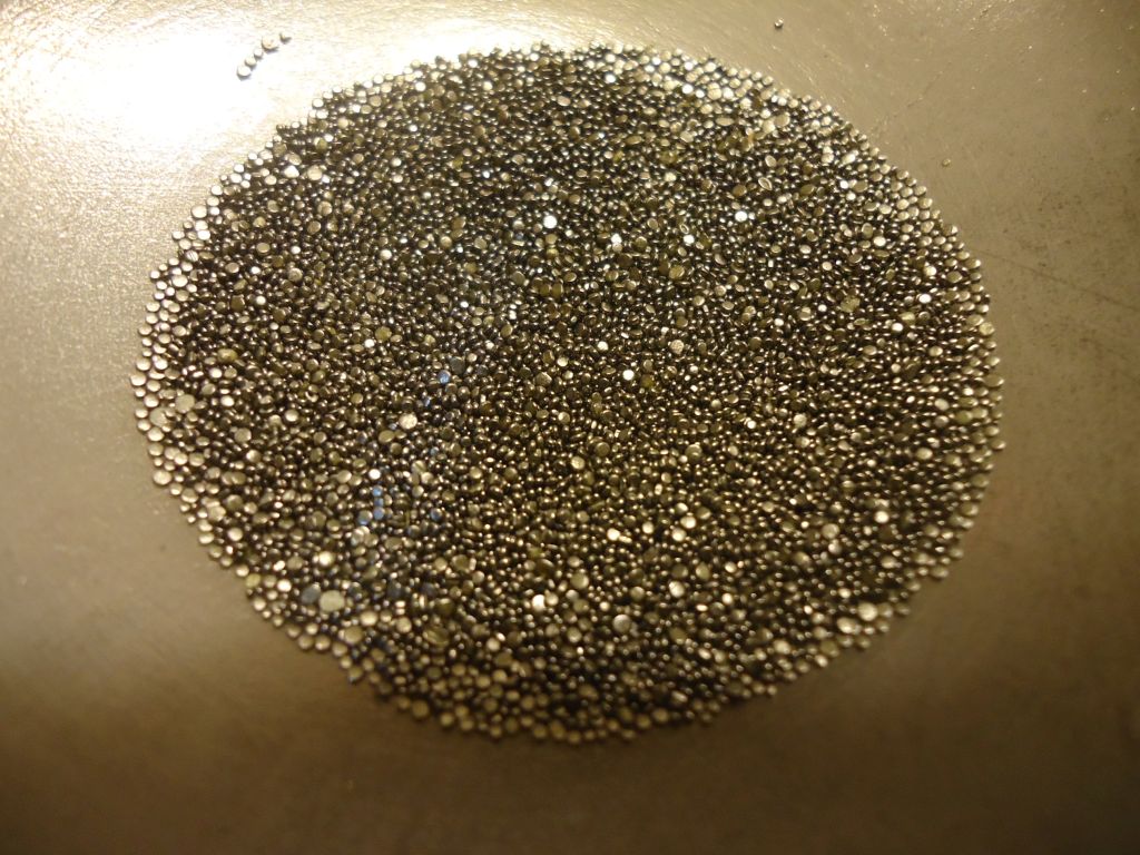

Any idea on what the powder is?
Hi
Being that this is European made I couldn't even speculate on what it might be. From its charge weight and velocity yield we can tell its burning rate is somewhere close to AA2460.. I would suspect that PPU contracted with maybe Nobel or some other European propellant manufacturer.
