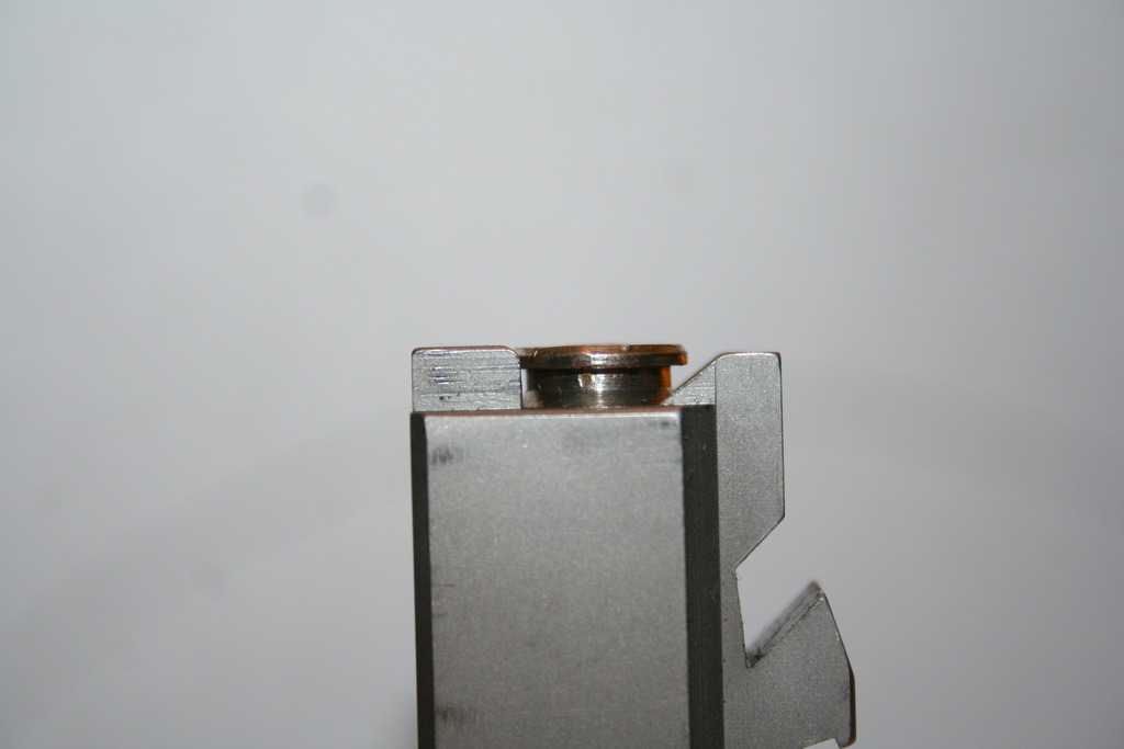

nhyrum, my first question is, are you pass through sizing your brass?  Most regular dies don't reach the area near the extractor cut where some loads can stretch or bulge the case.
by pass through sizing before regular sizing that can iron out that area.
The cases need to be sized so they are flush to the barrel hood and not less than 0.002" deeper.  If too deep light primer strikes can occur depending on the firearm.

The Dillon sizing die can over size the case pushing the neck back too far and that will cause the headspace to be deeper than necessary.  I work for flush with the barrel hood on mine.
Using the RCBS press and RCBS 10mm shell holder the Dillon die never touches the shellholder like when doing full length rifle case resizing.
I have added a RCBS lock ring so my Dillon Sizer never changes its setting...
Also as mentioned I run all cases through the LEE 10mm FCD with the guts removed as a pass through setup...ie "Bulge Buster".  That step has been very helpful with 10mm, 9x25, 40S&W & 357Sig.   I have also used a bulge buster set up for 380ACP, 45ACP and even 9mm Luger cases,  Because the 9mm is a tapered case, I'm using the Lee Carbide Factory Crimp Die 9x18mm (9mm Makarov) for that process.
