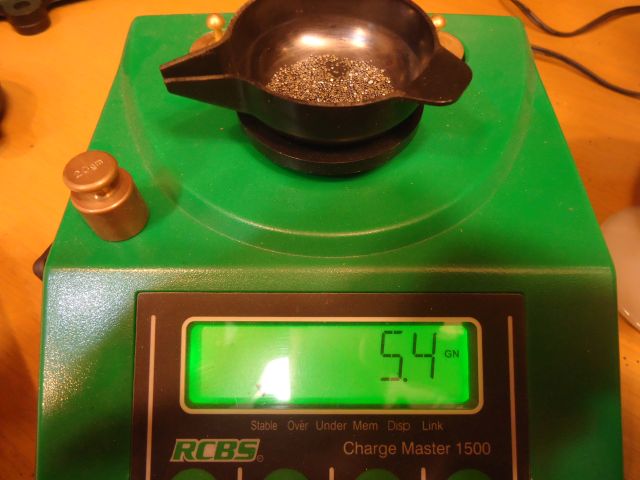

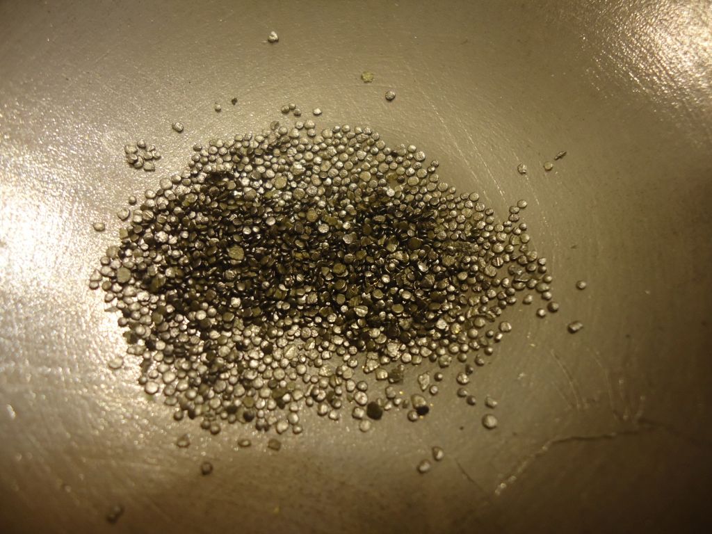

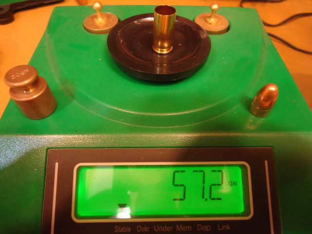

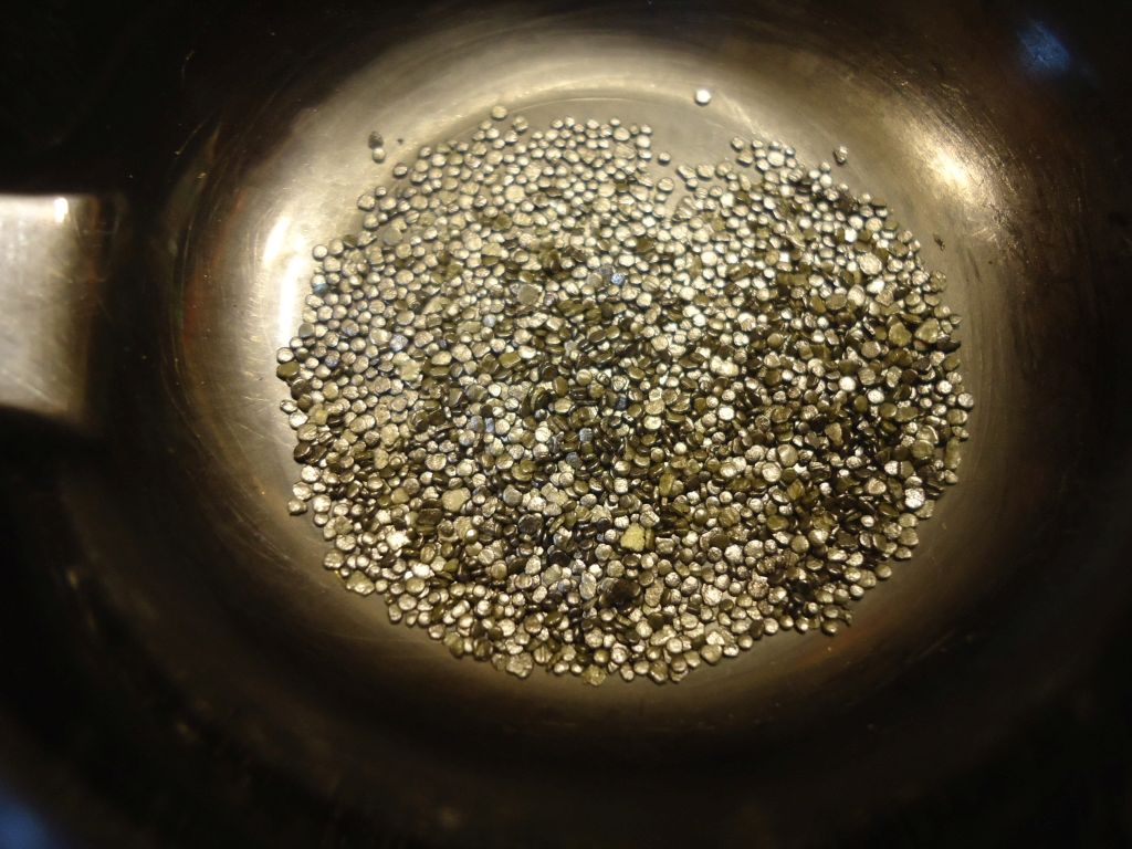

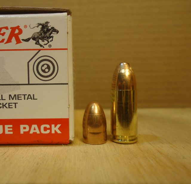

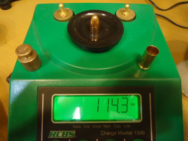

First thing I did was, do a pull-down on this Nosler factory ammo..

36.0grs yielded 2246 fps with no signs of excess pressure at all.
Then I tried some 748, H-335, CFE223, and ARComp.
Data for 748 was all over the place, so just to be safe I started with 34.0grs. I believe I could push that to 35.0 with no issues.
The other loads were about right, and CFE223 produced the best group.
My buddy said load the rest up with CFE223 and call it good.
