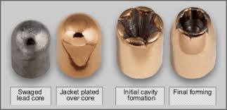

I have been told that all Blazer and the cheap red box Federal ammos are plated and not jacketed bullets.

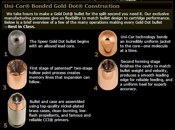

Even the Speer Gold Dots are a plated jacket and then swaged to form the bullet and HP.
It's a pretty cool technology Speer uses to make their awesome products 😊

Speer Gold Dots are not typical plated bullets like Xtreme or Berrys.
I've pushed GDHP to the limits of the cartridge in 10mm, .357 and 44 magnum.
"Regular" plated like Xtreme and Berrys can't handle those velocities.

AFAIK, Gold Dots are "bonded," not plated.
What's the difference?  Dunno, but GDs definitely perform better than mere "plated" bullets at high velocities.
Johnnyreloader
Has to do with the 'process' of getting copper onto lead.
Gold Dot uses some kind of proprietary process that bonds the two metals,
others use a pricess that limits speed of bullet because plating will rip off at high velocity.
