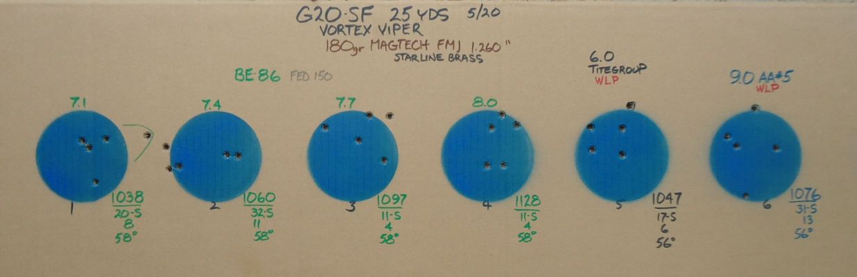

This is a continuation of what I started a few years ago;
http://10mm-firearms.com/reloading-10mm-ammo/sr-4756-workup-with-hornady-180gr-hap/
Today I took 4756 out a little farther using Magtech 180gr FMJ. I'm out of Hornady's..
Starline brass was used.
Started with 8.8grs and ended with 9.4grs.
Here is the expansion data;
8.8grs  .4338, .4335, .4335, .4337, .4332"
9.1grs  .4335, .4332, .4337, .4339, .4340"
9.4grs  .4336, .4332, .4343, .4342, .4344"
The Magtechs run a bit slower than the Hornadys.
So at 9.4grs I started running into expansion over the .4340" mark. So, at least in this Glock with the unsupported chamber, SR4756 maxes out at about 9.0, 9.1grs..
9.1grs shot the best group anyway.
