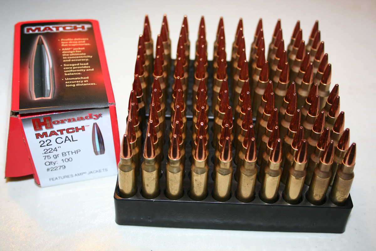

I've been rolling my 223's with Hodgdon's CFE223 with good results with my 1:7 twist barrel  have some 55 grain FMJ BT's loaded with IM3031that I need to test out.
Some 75 grain Hornady
CFE223 powder 24.6 grain
CCI400 SRP and Winchester SRP
Velocity    2750 fps 20" BBL - 2650 fps 16" BBL
Energy   1293 ft/lbs       - 1169 ft lbs
Cartridge Overall Length 2.2480"-2.2500"
55grain
IMR 3031 powder 24.2 grain
CCI400 SRP
Velocity  3000 fps 16" BBL
Energy 1099 ft/lbs
Cartridge Overall Length 2.2400"
