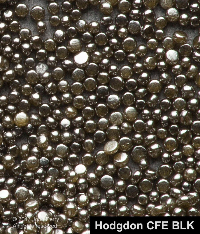

Craig, I cant be totally sure but we may be looking at the Hodgdon CFE Black powder.  However Winchester is one that will blend powders for what they want...like they did for AA#9 back in the early days where they Blended WC820 & WC350.
Hodgdon CFE Black
The powder is more uniform than your pictures but I did find some wierd stuff mixed in to the secound round I unloaded. but almost 1 particle for every 300 parts of powder. Go figure. I will call Winchester on monday as a friend at the local gun shop said he had a friend that got all kinds of load data from them.It's worth a try as when I called them yesterday they said the guns would not be out untill the end of August. Craig
Those strange particles may be some flash suppressant and copper fouling reducing agents?  ???  I know I see that in other powders newer to the markets as well...
After calling Winchester and been given the ammo number I call and after talking to several people was put into a persons voicemail. Well I will call again when I can. Craig
Called Win this morning and talked to the ammo guy and Wade was correct in his guess that this is a special mix powder that I could get no info from the guy. Don't really care as I will work up my own load with Lil Gun or the like.  Craig

cwlongshot, can you post a picture of the actual powder of the factory loads?  Interesting about spiking pressures.
cwlongshot
I didnt take a pic of it.
Its very round close to powders in 22 magnums I have pulled.
