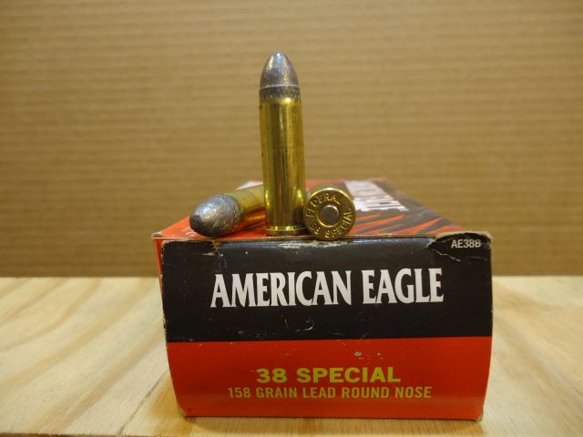

Cartridge is from Ammo Manufacture:  Federal American Eagle 158gr Lead RN
Muzzle Velocity; Advertised:   770 fps   Barrel length not mentioned

Brass Make/Headstamp:  FEDERAL 38 SPL

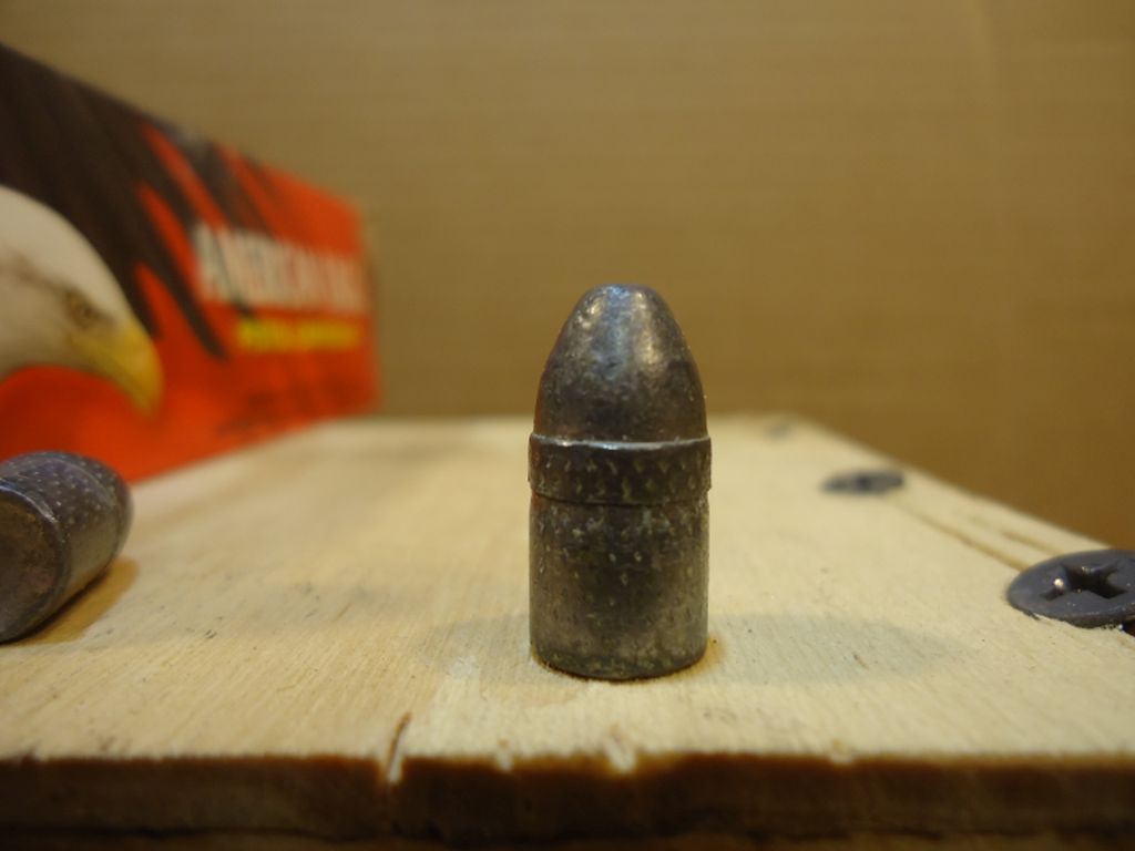

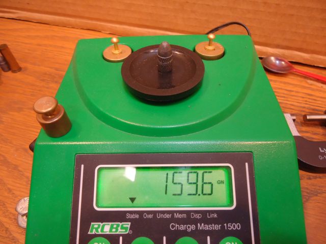

Bullet Make/Weight/Construction/Info:  Federal 158gr Swaged Lead RN
Actual Weight:  1)  159.5grs.  Diameter; .3557- .3560"  Length;  .715"
                       2)  159.6grs.  Diameter;  .3557- .3560"  Length;  .715"

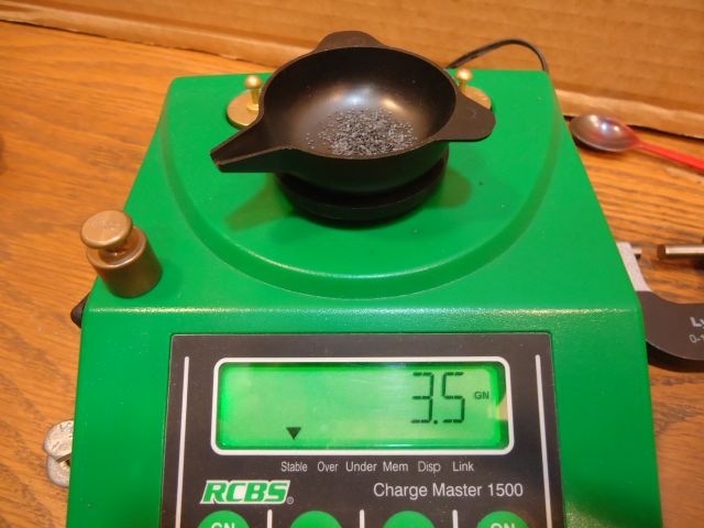

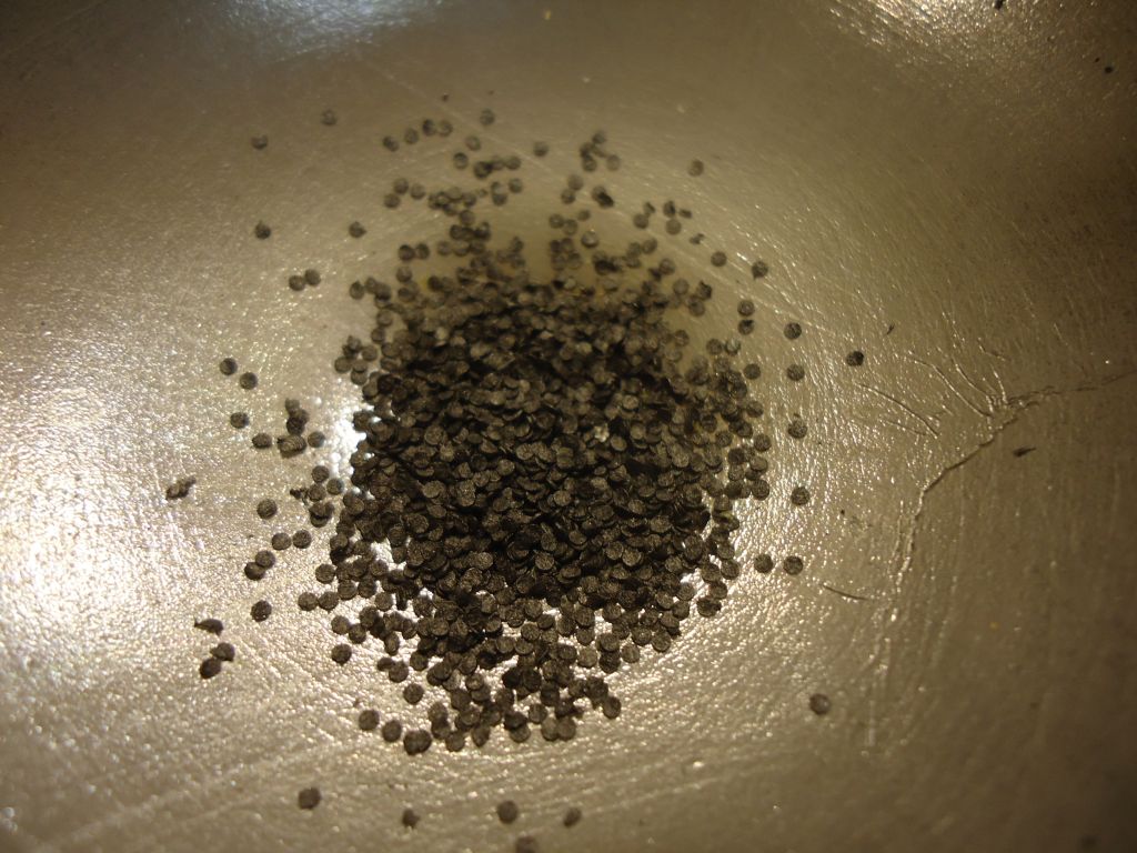

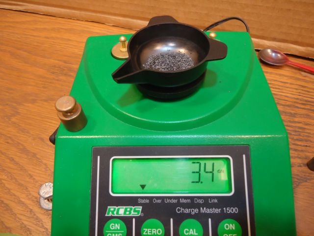

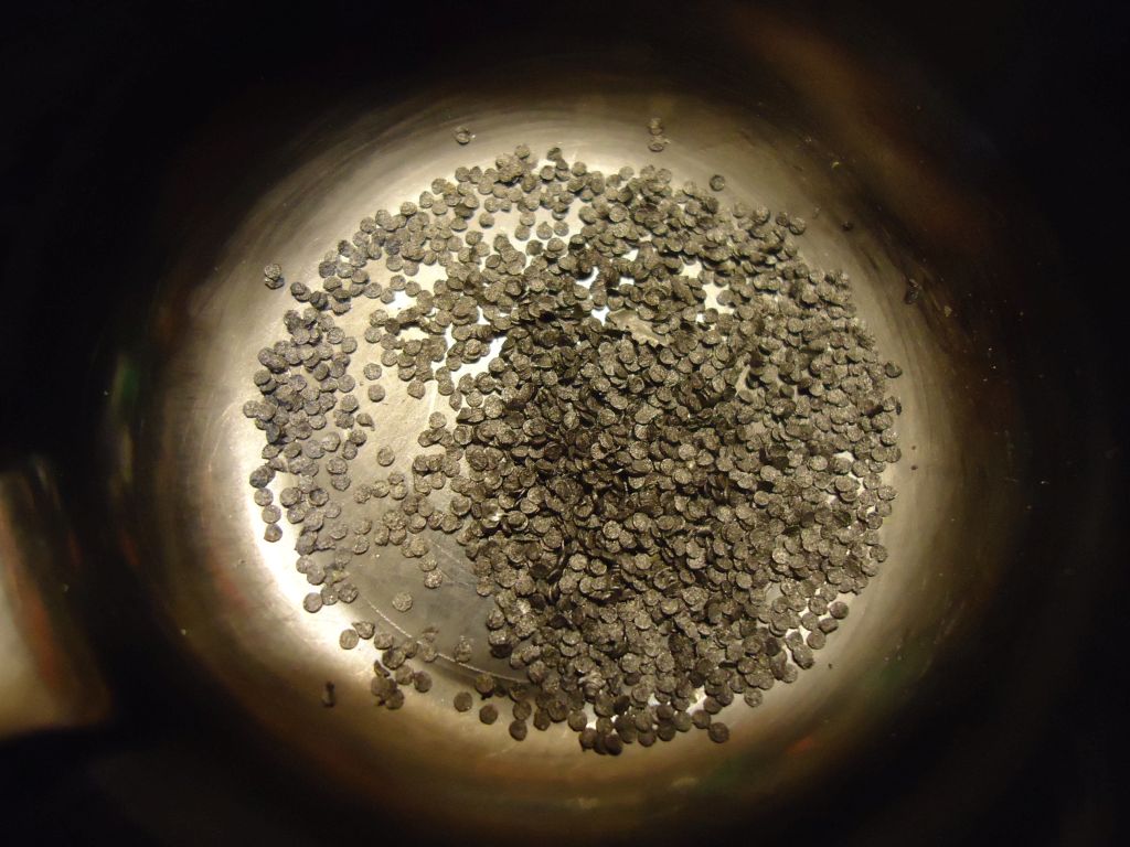

Powder Description/Positive ID/Type/Charge Weight:  Small Flake;  Bullseye?
1)   3.4grs.
2)   3.5grs.
