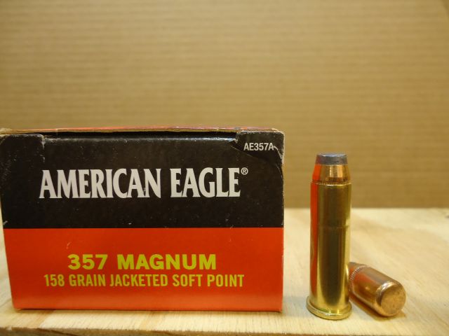

357 MAG Fed American Eagle 158gr Jacketed Soft Point
Started by RDub01, April 09 2019 06:30:13 PM MDT

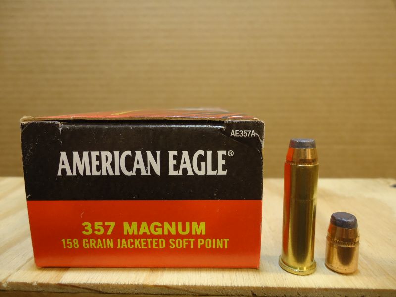

Cartridge is from Ammo Manufacture:  Federal American Eagle 158gr JSP

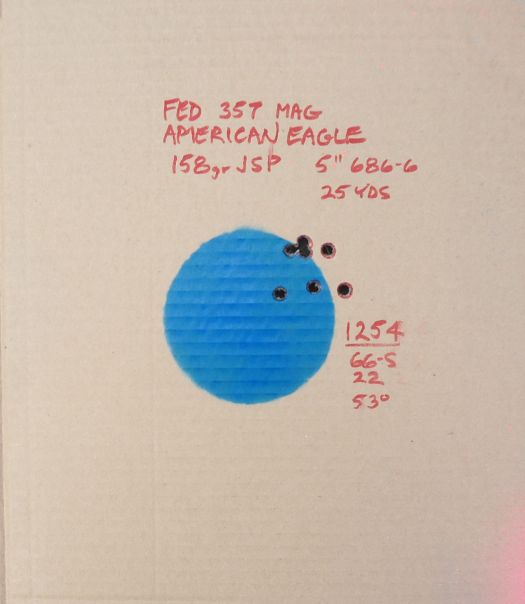

Muzzle Velocity; Advertised:   1240 fps  No barrel length mentioned
Actual Instrumental Velocity:   1254 fps 5" barrel
Muzzle Energy; Advertised:   539 ft/lbs.
Target circle 4"

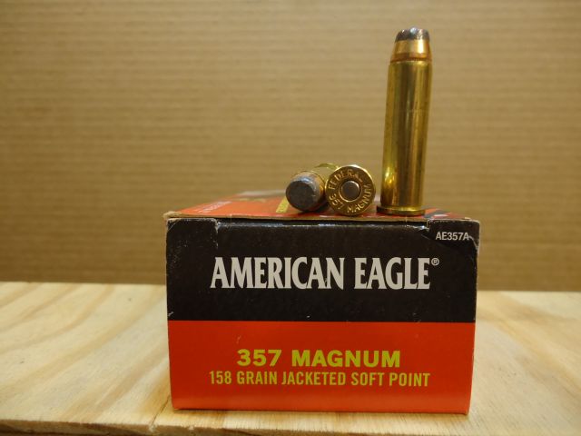

Brass Make/Headstamp:  FEDERAL 357 MAGNUM
Bullet Make/Weight/Construction/Info:  Federal 158gr Jacketed Soft Point
Actual Weight:  158.5grs.
                              Diameter;  .3570"
                              Length;   .652"
Crimp diameter:  .375"
C.O.A.L.:   1.554"
Primer:  Nickel  Fed 200
Case:  Brass

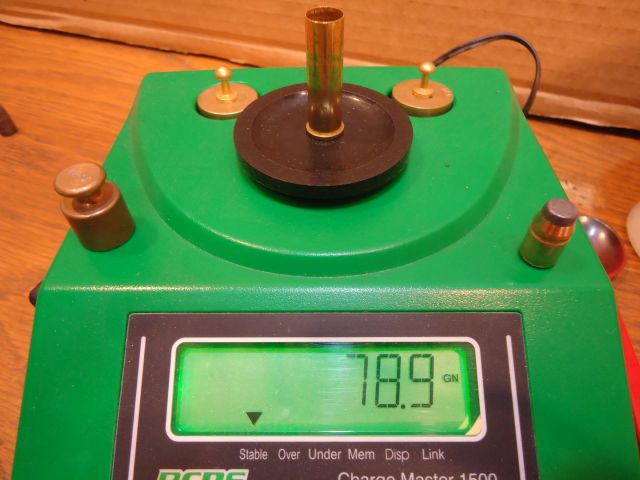

              Wt. w/primer;  79.0grs.
               Length;  1.282"

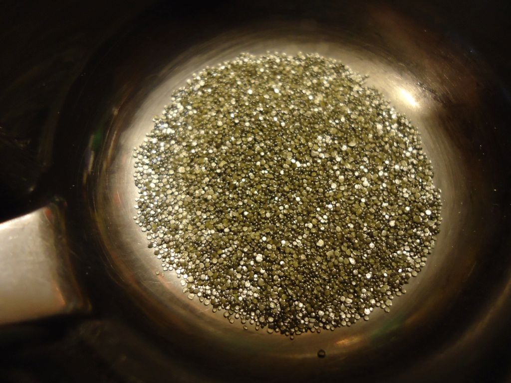

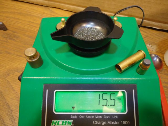

Powder Description/Positive ID/Type/Charge Weight:  H-110?;  Flattened Ball;  15.5grs.
Nice shooting load for the 5" 686-6 Plus.
Very nice!  Typical 357 loading that most companies use.
