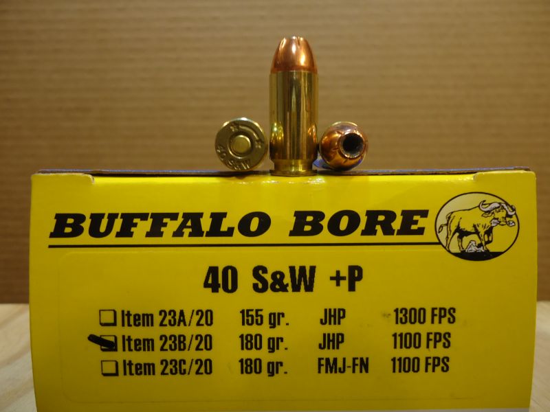

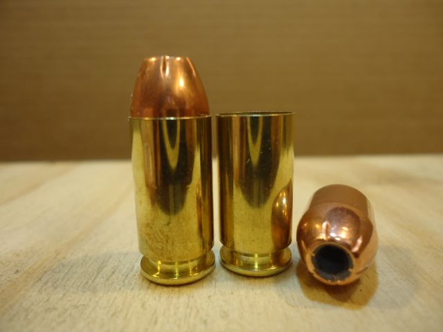

Cartridge is from Ammo Manufacture:  Buffalo Bore 23B
Muzzle Velocity; Advertised: 1100 fps
Actual Instrumental Velocity:   1083 fps  41°F
Muzzle Energy; Advertised:  484 ft. lbs.

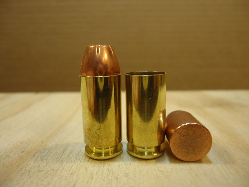

Brass Make/Head Stamp: StarLine 40 S&W
Bullet Make/Weight/construction/Info: Hornady? 180gr Jacketed Hollow Point  .4000" dia; .620" long

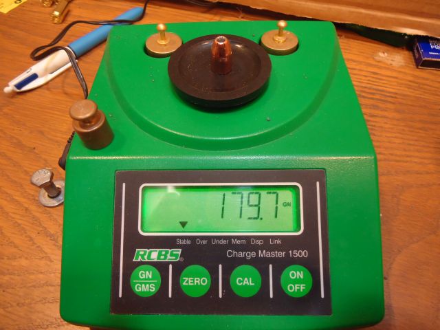

Actual Weight:  179.7 grs.
Crimp diameter: .4208"
C.O.A.L.:  1.128"
Primer: brass color
Case: Brass

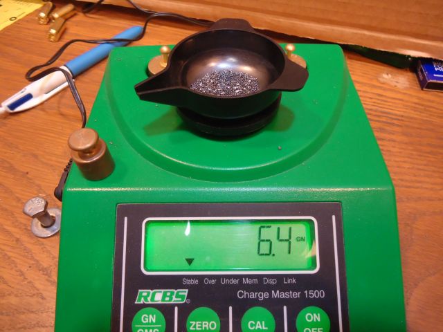

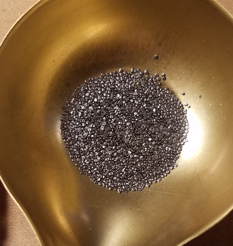

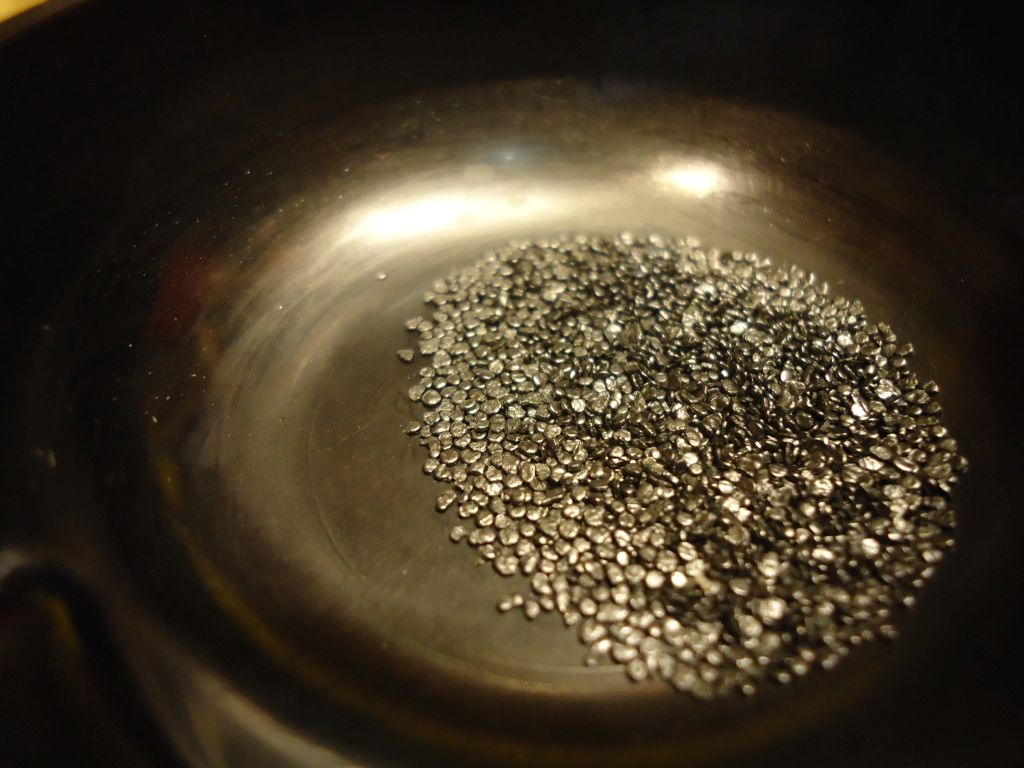

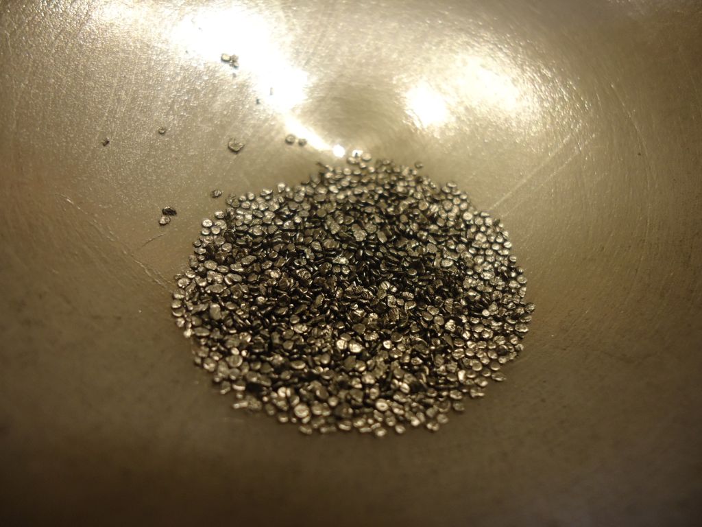

Powder Description/Positive ID/Type/Charge Weight: Flattened Ball; 6.4grs.

The primer on the outside looks like a Winchester primer, but the inside charge is basically the same color as the anvil.  Winchester primer charge is either green or red depending if it is a WSPM or WSP.  This primer did not look like either one.
This appears to be CFE Pistol powder and seems to fit the velocity profile as well.

The powder looks VERY similar to the powder from the S&W Outdoorsman HC-FN 200 gr std pressure that I pulled down recently. 5.5 gr rated at 1000 fps, although I haven't collected chrony data.
It matched none of the handgun/shotshell powder that I had onhand (I don't have CFE Pistol).
Taterhead, that powder looks like Longshot and that Longshot may actually be what is in RDub's BB loading as well.  Have seen DT use Longshot in his 40S&W load as well.
Taterhead
#4
Shadow, That was my first thought (geat minds think alike!), so I compared it to LS (side-by-side). They were definitely different. LS granules were noticeably larger, more irregular, and the color was a different shade. So it was easy to rule out LS.
Of the flattened spherical powders, I also looked at WSF, Silhouette, 231, No. 5, and I'm probably forgetting one or two. No matches.
HS6 could be similar but 5.5 grains is only 810 fps @ 27,000 psi with the 200 XTP and 6.3 makes 900 fps @ 32,800 psi
