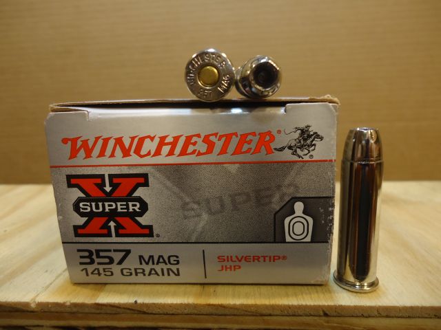

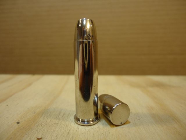

Cartridge is from Ammo Manufacture:  Winchester 357 Mag
Muzzle Velocity; Advertised:  1290 fps
Actual Instrumental Velocity:   1156 fps  4" barrel  39°F
Muzzle Energy; Advertised:   536 ft/lbs
4" target circle.
Brass Make/Headstamp:  Winchester 357 MAG

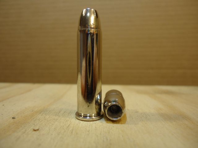

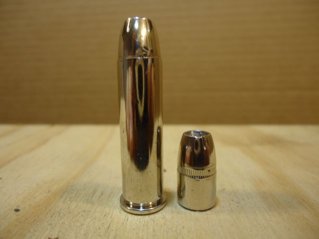

Bullet Make/Weight/Contruction/Info: Winchester SilverTip 145grs. JHP .3556" dia.  .659" long

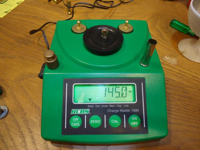

Actual Weight:  145grs.
Crimp diameter:
C.O.A.L.:   1.576"
Primer:   WSPM  brass color

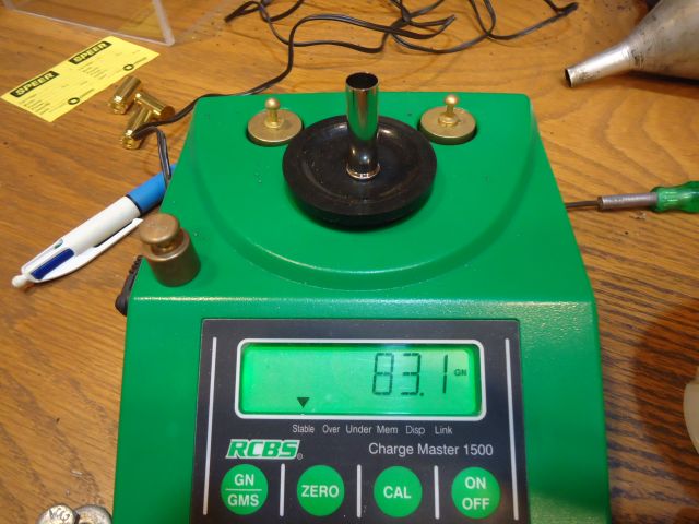

Case: Nickel  1.280" long.  83.1grs w/primer

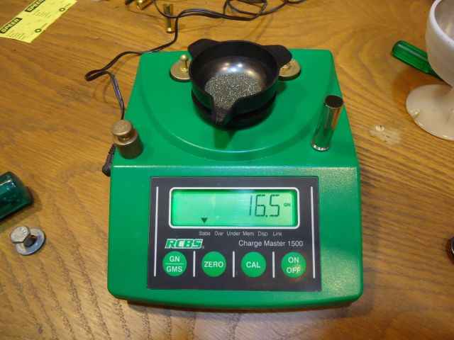

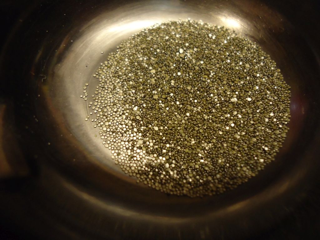

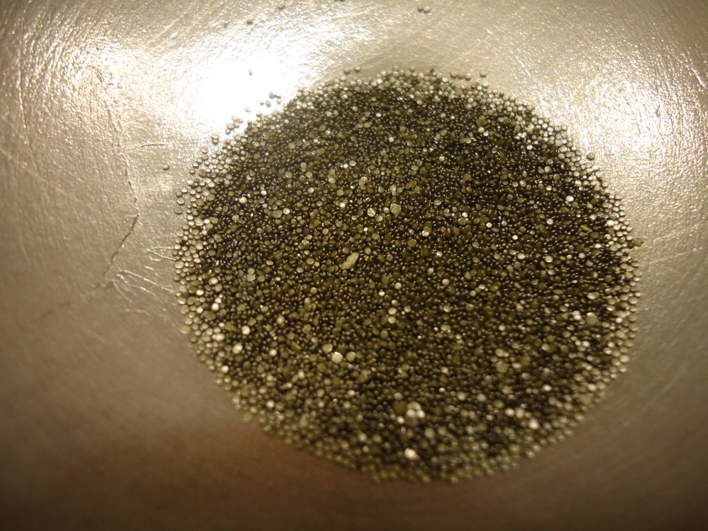

Powder Description/Positive ID/Type/Charge Weight: Flattened Ball;  16.5grs;  H-110/296
Note unusually small bullet diameter.
Those look like they are a little light on the crimp for 296 powder... ::)  The burn may be better with the heavier crimp and improve the velocity too.
