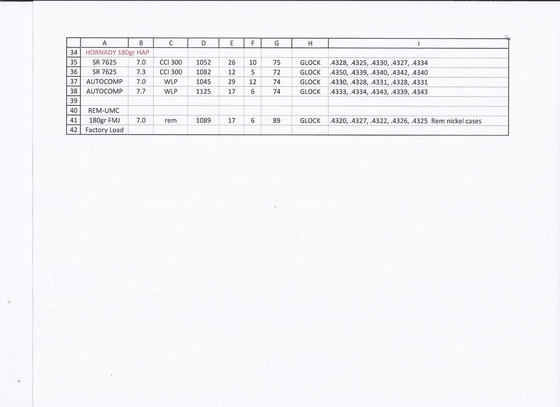

I have to include this powder in this exercise so I'll finish off with some Hornady 180gr HAP bullets.  I loaded up five rounds of 7.0 and 7.7grs of AUTOCOMP with the HAP bullet and WLP primers.  Just to make the exercise more complete, went ahead and loaded five rounds with 7.0grs of SR 7625 and CCI 300 primers and see what happens.
Well with the exception of one of those mystery flyers, SR7625 did pretty well..  Could take it up a tenth or two maybe.
AUTOCOMP delivered the highest velocity of all these tested.  7.7grs is definitely a max load.. No question about that.

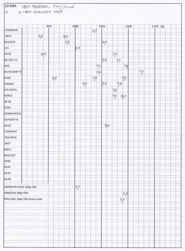

So.. As to the original question;  Is there anything that duplicates the Armscor or REM-UMC load charge =velocity?..  No.  Some come close but no cigar..
So it seems the factories are using some pretty unique propellants to get that level of velocity with a relatively modest charge weight.
Here is the graph for this project and spread sheets;
9-17-17; I shot a group with 7.3grs of SR7625.  The data is reflected on new graph and spreadsheet.  And here is a target;
The one case which expanded to .4350" is troubling..  I believe the listed 7.0grs. is just about right.
