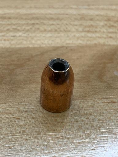

Bullet Make/Weight/Construction/Info; Length 0. 7245"/Dia. 0.4300": JHP 240gr
HP Depth: 0.1800" / HP Dia.: 0.1760" (tapered)  crimp groove: 0.4265"

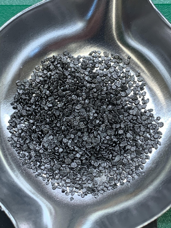

Powder Description/Positive ID/Type/Charge ?? H-110 or 296 ?? Weight: 22.0 grains  (Lighter in color and has some yellow dust in the mix)

Cartridge is from Ammo Manufacture: Underwood Ammo  240gr  Hornady XTP
Ballistics Information: 44 Magnum
Muzzle Velocity: 1550 fps
Muzzle Energy: 1280 ft. lbs
Brass Make/Headstamp: StarLine - Brass
Bullet Make/Weight/Construction/Info; Length 0.7035"/Dia. 0.4300": 240gr.Hornady XTP

Powder Description/Positive ID/Type/Charge Weight: ?  ? 23.4 grains *  (very fine flatten ball)(similar to H-110 / 296 performance by weight)
