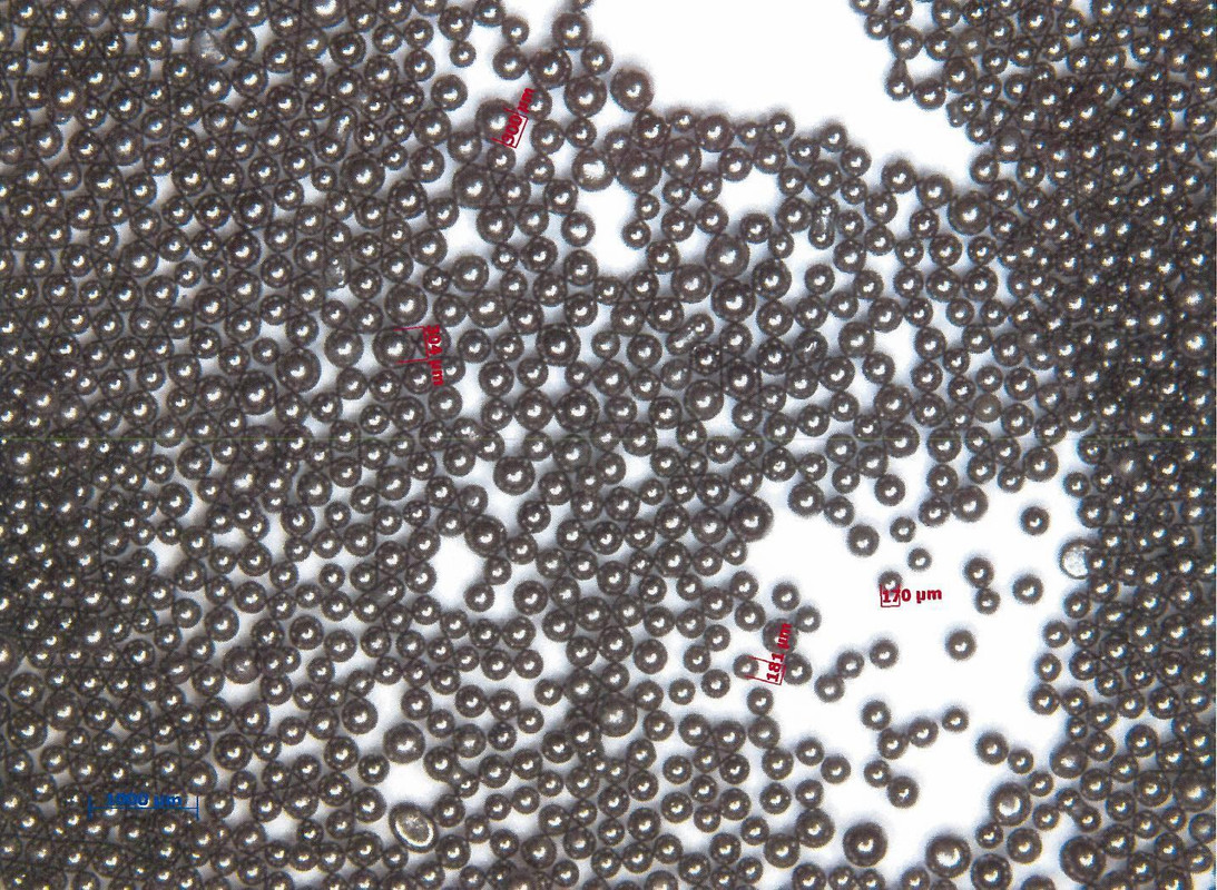

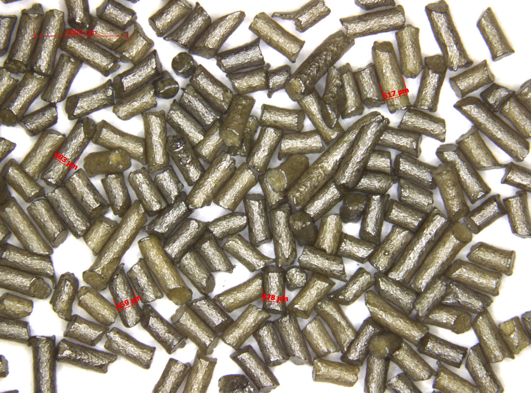

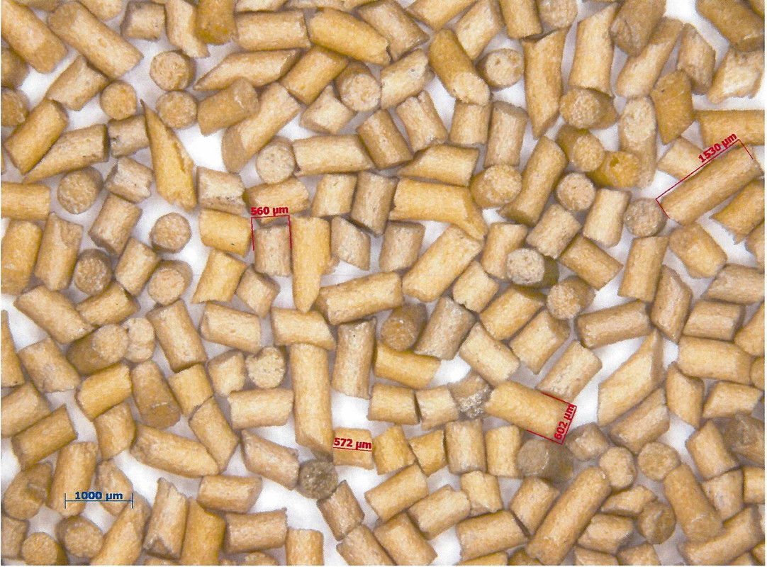

Juergen would you post a picture of the Rottweil P 806 powder in a scale pan.  I like to study these actual powders out there.  We don't have those powders here
Only Rottweil Powder picture I have in my files is Rottweil_P804 & Rottweil_P805 and Rottweil_30_carbine powder.
Rottweil_P804
Rottweil_P805
Rottweil 30carbine ??
Juergen
