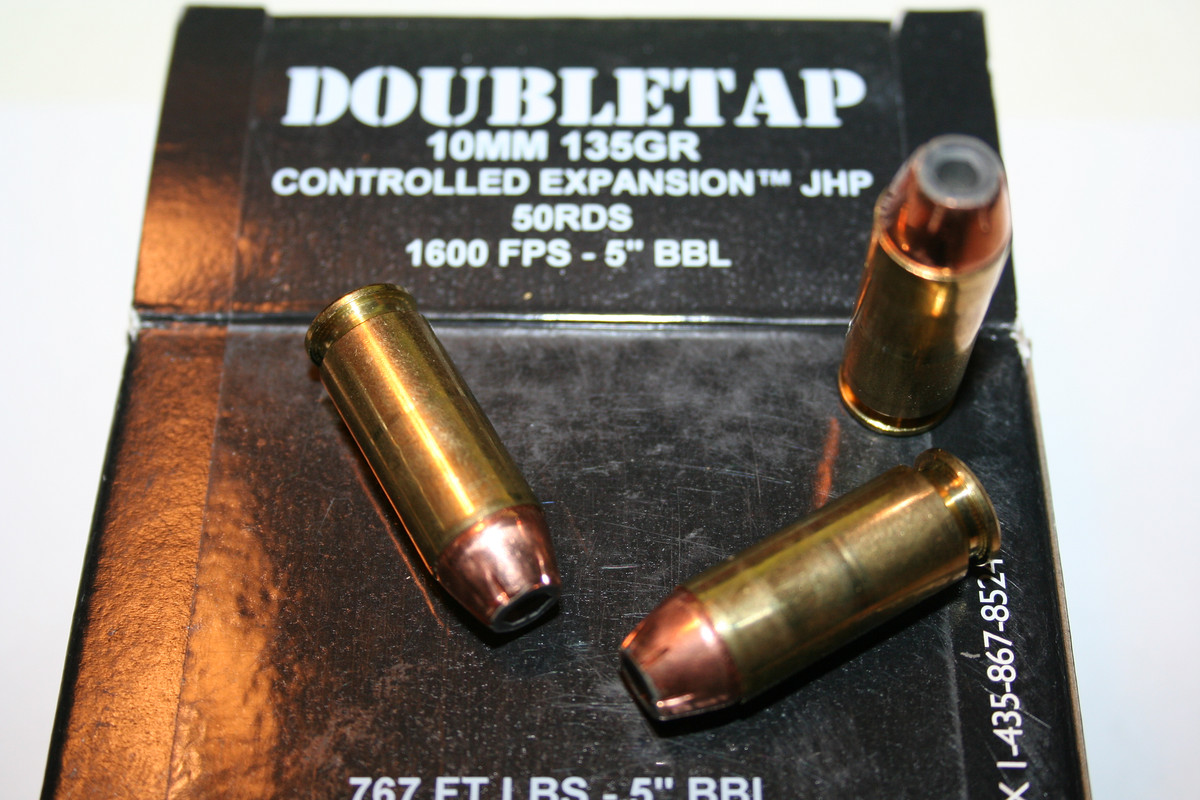

Cartridge is from Ammo Manufacture: Double Tap 200gr Control Expansion (Redline 8/19)
Muzzle Velocity: 1250 fps from 5" BBL
Muzzle Energy: 694 ft. lbs
Brass Make/Headstamp: JAG - Brass
Bullet Make/Weight/Construction/Info; Length 0.6830"/Dia. 0.4000": DT Custom 200gr. JHP
HP Depth 0.2005" / inside Dia. 0.2260" tapered / mouth Dia. 0.2740"
Actual weight 200.0 / 200.0 / 200.0 grains / Flat base / Crimp squeezed bullet to 0.3945"
C.O.A.L.: 1.2450" / 1.2455" / 1.2445"
Case: Diameter 0.4220" Crimp Diameter 0.4205" (Tight) Length 0.9870"

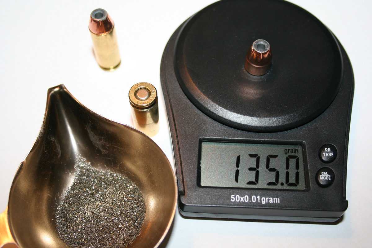

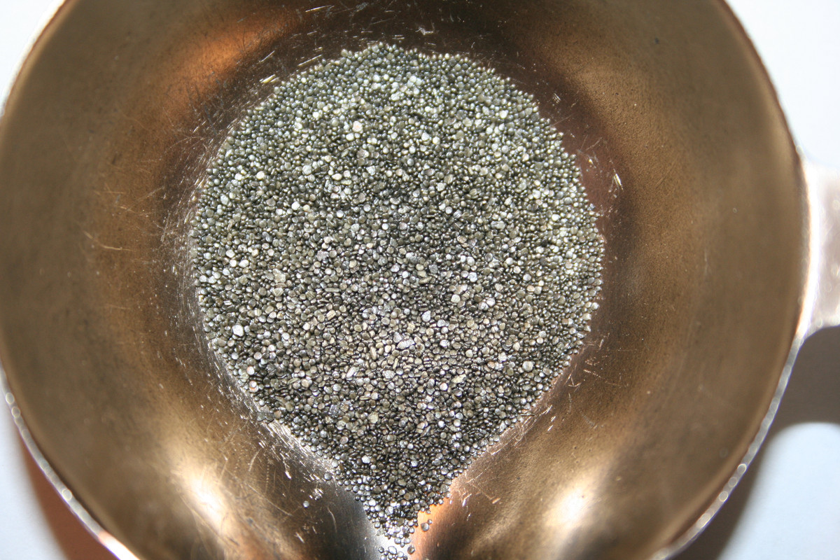

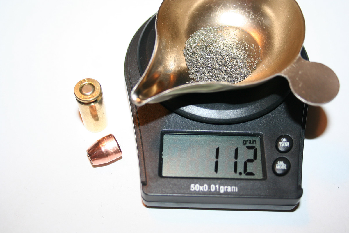

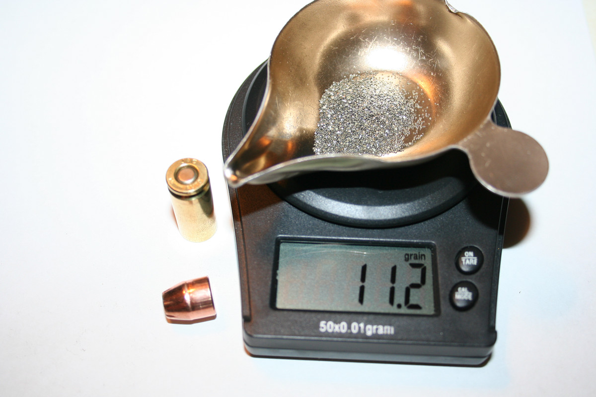

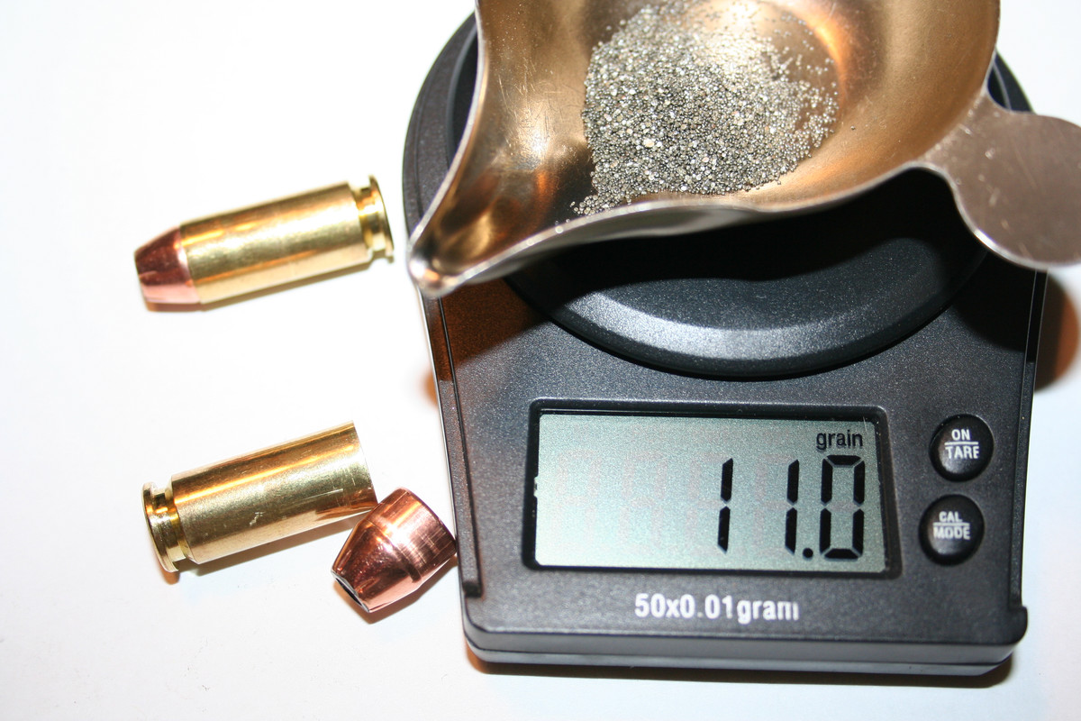

Powder Description/Positive ID/Type/Charge ? Silhouette ?
Weight: 7.8 / 7.8 / 7.8 grains
Cartridge weight: 287.4 / 287.4 / 287.2

Missed taking the picture of the powder of the first one.

I still trying to decide if the powder Double Tap is using may be Ramshot Silhouette but looks different than past samples. :-\
Performance wise I think the powder is Ramshot Silhouette.  :-\
