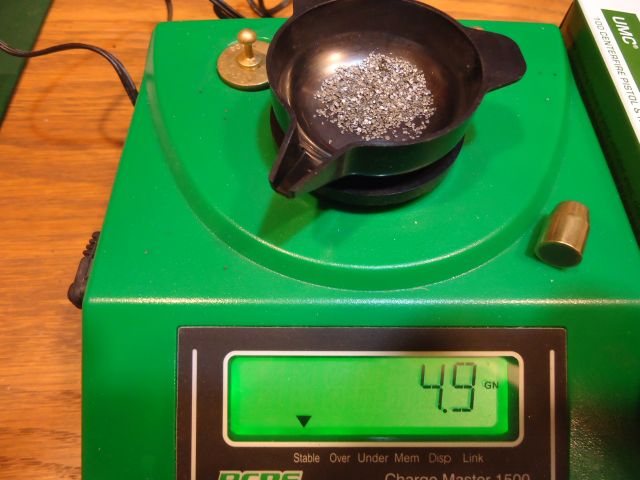

#15
Cartridge is from Ammo Manufacture: Underwood 255gr +P Hard Cast (21BHN) (supplied by MT10mm)
Ballistics Information: 45 ACP +P
Muzzle Velocity: 925 fps
Muzzle Energy: 484 ft lb
Brass Make/Headstamp: Star Line – Brass +P
Bullet Make/Weight/Construction/Info; Length 0.6690"/Dia. 0.4520": 255 gr. HCFN
Actual weight 245.0 grains (exposed lead base) Crimp line N/A
MEPLAT: 0.2850"
C.O.A.L.: 1.2040"
Case: Diameter 0.4710" Crimp Diameter 0.4725" Length 0.8930"

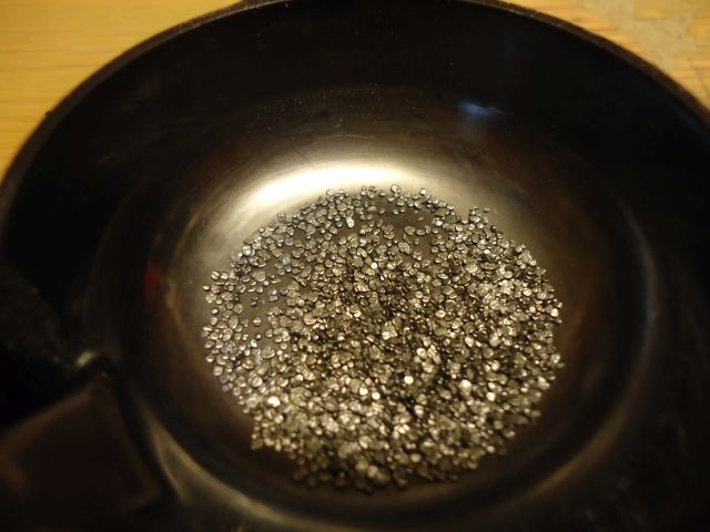

Powder Description/Positive ID/Type/Charge Weight: LOVEX D037-01 11.4 grains *
* (very fine irregular ball) (D037-01 same as AA#7 by weight)

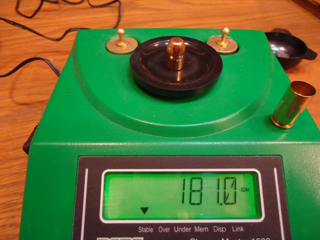

#16
Cartridge is from Ammo Manufacture: Underwood Hornady 230gr XTP +P (supplied by MT10mm)
Muzzle Velocity: 1000 fps
Bullet Make/Weight/Construction/Info; Length 0.6550"/Dia. 0.4515": 230 gr. XTP
Actual weight 230.2 grains (exposed lead base) Crimp line N/A
HP depth: 0.2540" / HP dia: 0.1700" tapered / Mouth 0.2880"
C.O.A.L.: 1.2420"   (flat base)
Case: Diameter 0.4710" Crimp Diameter 0.4715" Length 0.8930"
Powder Description/Positive ID/Type/Charge Weight: LOVEX D037-01 11.8 grains *
