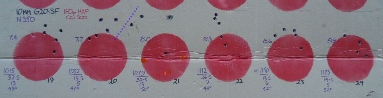

Recently tested True Blue and N350 with a bone stock Glock20-SF, using Hornady 180 HAP bullets, in 0.3gr increments miking cases for pressure.
And shot a few feeler loads with BE-86.
Data on the targets from top down;
velocity
extreme spread
standard deviation
temp F°
Everything was shot at 25 yards.  Circles are 5½"  Std 25 yrd pistol target black.

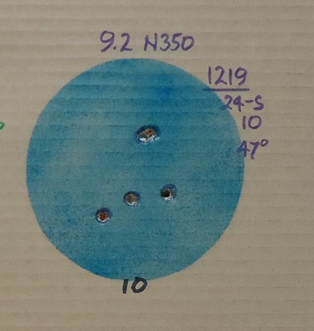

N350:
N350 shot well in this gun.  Even the 9.2gr load, which was a little hot for this gun, shot nicely.  I was especially pleased with the low standard deviations.
In this gun 8.9 or 9.0grs is as much as I would want to load.

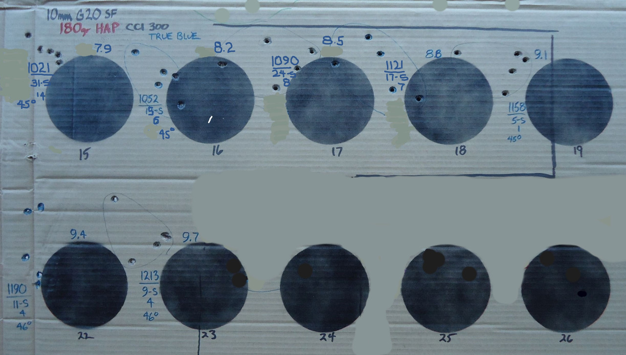

As for True Blue, I couldn't hold groups very well.  However the standard deviations were equally impressive.
Got smileys at 9.7grs and 9.4 was pretty warm.

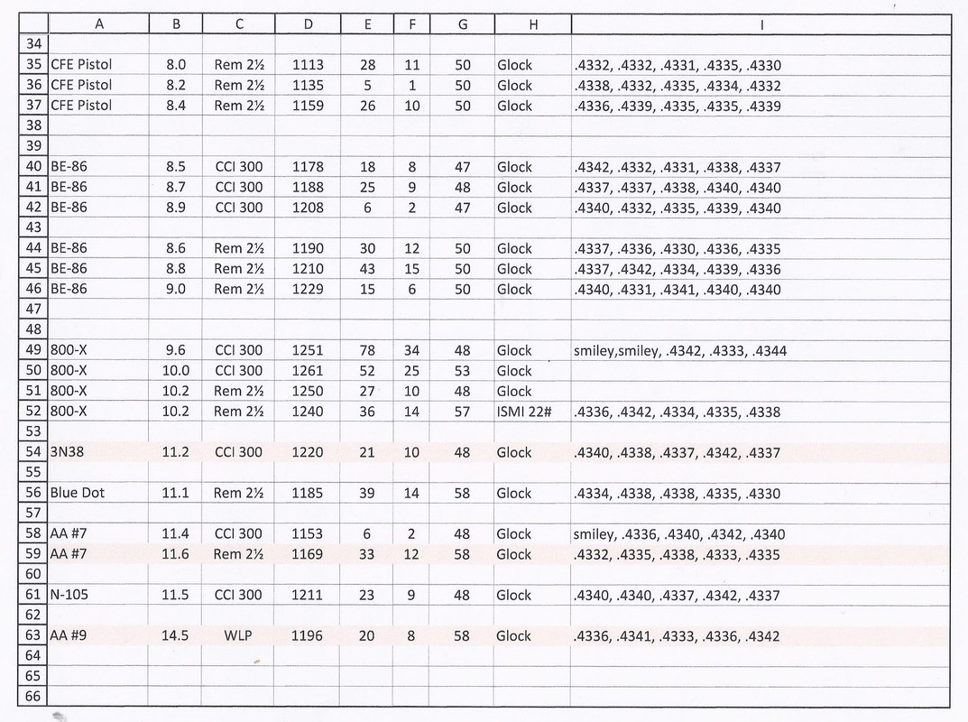

BE-86;
Alliant shows 8.5 grs in their loading data and they list a velocity of 1265 fps
Well that didn't quite happen in this gun.
Miking the cases indicated that this was not a max load for 10mm.  So I shot two more increments of 0.2grs.
With the CCI primer the standard deviation was quite good.  Groups were ok, but not as good as N350.  I stopped here for now.  Case measurements indicate maybe one or two more increments.

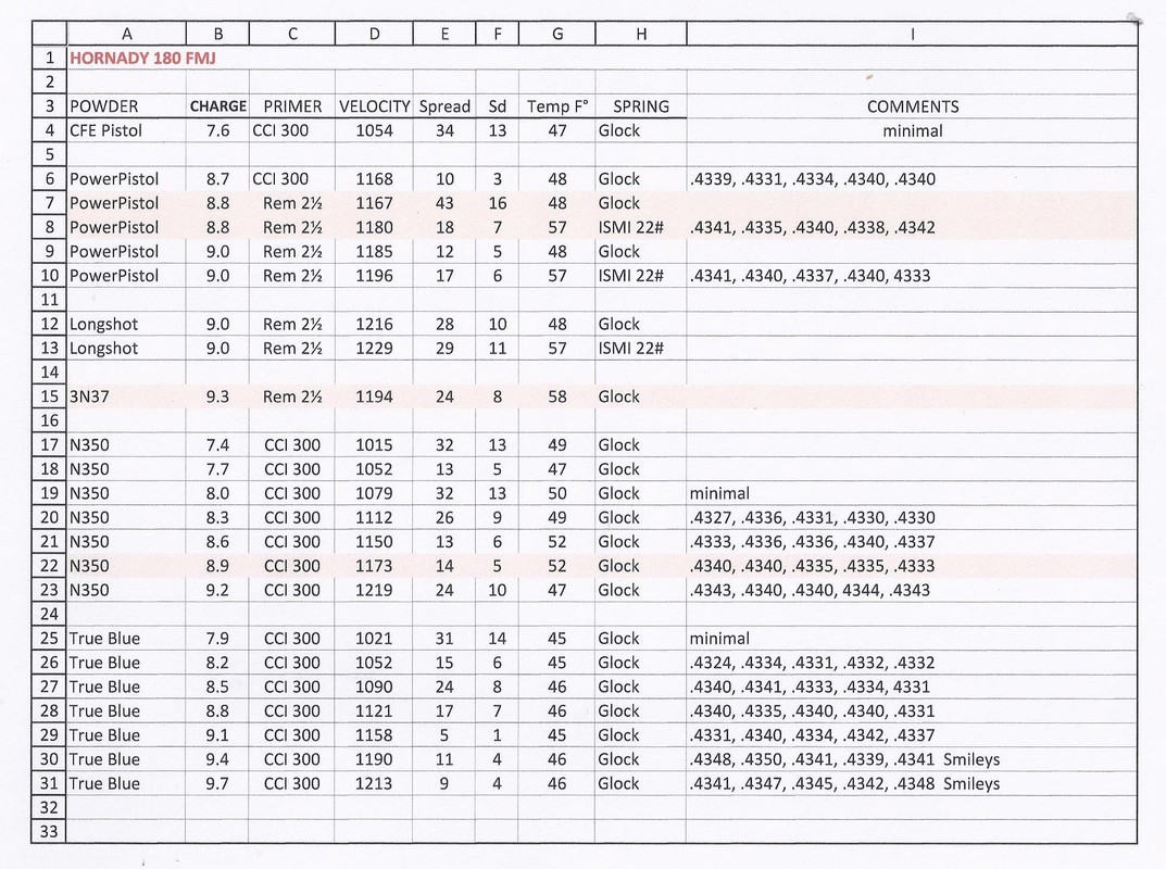

Here is a spreadsheet of where I'm at with the Hornaday bullet;
When I start to see .4342" when working up, it's time to stop.  I've never seen a miked case of .4346" or larger that wasn't a smiley.
Of course everyone knows that data developed in one gun is necessarily going to duplicate in another.  One should always work up loads carefully in their own guns.
